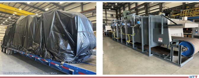

A mesh belt temper furnace has been shipped to a manufacturer in the U.S. South. The client will use this heat treat furnace for preheating and tempering steel bar stock.
Mesh belt temper furnace packed and shipped
(Source: Premier Furnace Specialists. Inc./BeaverMatic)

"We had built the client a similar furnace in 2022," commented Steve Ignash, sales engineer at Premier Furnace Specialists, Inc./BeaverMatic. "Our furnace gave them the confidence to purchase five more of the similar style to replace outdated equipment and add to their current increase in production."
The remaining four furnaces from the recent purchase will be completed and installed through January 2024.
