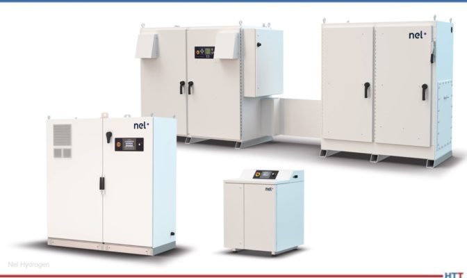

Heat Treat Radio #125: On-Site Hydrogen Generation — A Reliable Path for Heat Treaters
Hydrogen is essential for many heat treating processes, but what happens when your supply runs out?
In today’s episode of Heat Treat Radio, Devon Landry of Nel Hydrogen joins Heat Treat Radio Host Doug Glenn to discuss the potential risks of delivered gas and how on-site generation can secure reliable, high-purity hydrogen. This episode highlights the advantages of on-site generation and what questions to ask before making the switch.
Hydrogen Usage in Thermal Processing (4:05)
Doug Glenn: All right, let’s talk hydrogen. I think the first thing I’d like to do is talk about the basics, how hydrogen is used and what it’s used for in thermal processing.
Can you give us a 30,000-foot view on hydrogen and why are we using it in thermal processes?
Devon Landry: Hydrogen is widely used in heat treat and processing. It’s a powerful reducing agent for surface cleaning and sintering success.
