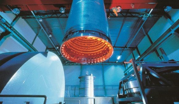

HTD Size-PR LogoA medical device manufacturer is set to receive a vacuum furnace for annealing and brazing processes at their plant in France. The parts processed in this furnace will include X-ray and radiotherapy equipment among other products that require high quality standards of heat treatment.
The vacuum furnace scheduled for delivery is called the Vector®. "[This furnace] has proven performance in many fields in precision industries such as aviation, automotive and medical branches," commented Maciej Korecki, vice president of the Vacuum Furnace Segment at SECO/WARWICK Group, and international heat treat systems supplier. Korecki continued, "This time, our partner is an expert when it comes to brazing complex components that require high precision."
The high-tech medical industry is one of the most demanding industries in terms of standards, procedures, and process parameters to be met by the equipment involved in the production process. Medical equipment components (e.g., RF components, X-ray tube components, ceramic components) are precision manufactured to the highest quality standards. This is because these components are used for processes that are decisive not only for the quality of treatment, but also for human life.
Find this product and search this supplier's North American location listing on Heat Treat Buyers Guide.com
Delivery Scheduled for Medical Brazing Heat Treat Solution Read More »
