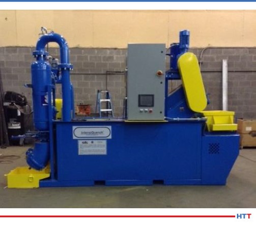

Examples of DFIQ equipment
(Photo source: Joe Powell)

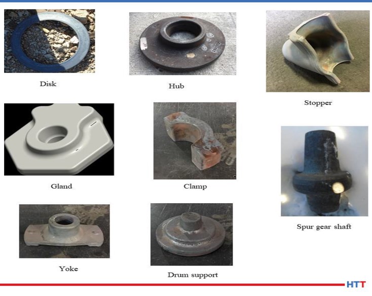

DG:  Can you tell us what parts were actually run?
JP:  Yes, there were a variety of parts, and they're all pictured in that report.  They ranged from a link that weighed, I believe, close to 50 pounds all the way down to a tine that was on a tiller machine (ground engaging tool) that went into a piece of farming equipment.  One of the parts in between was a pintle adapter that was basically a mounting post for a machine gun for the Army.  This part went through several operations.  It's documented in the report, but we basically saved $13 per part to the Army by eliminating the multiple steps that took place after forging and just incorporated it into an integrated heat treating solution right there at the trim die.

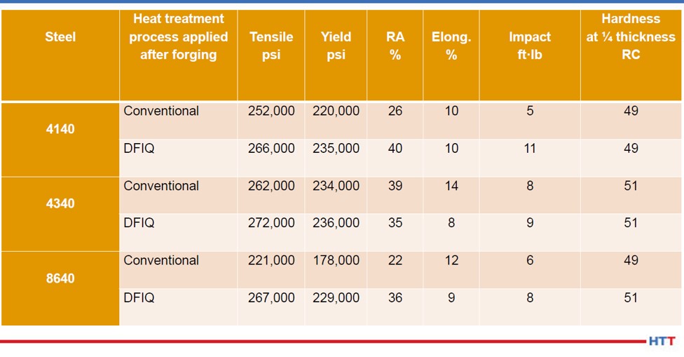

DG:  Let's talk very briefly about the benefits.  We've already alluded to quite a few of them, but let's try to enumerate them here.  What are the benefits to a captive forge shop in considering a DFIQ type system- why do it?  What's the commercial value?
JP:  We can save up to 66% of the energy that's needed to heat treat that part.  The part comes off the trim die and is cooled in a box or set aside somewhere.  Next, it needs to be reheated and normalized.  Then, it has to be reheated a third time and austenitized before quench and temper, and that's a lot of energy.  And it's also not usually done at the forge plant.  It's usually done either at a captive heat treat that is integrated with the forging company or it goes to a commercial heat treat where they use huge continuous furnaces to reheat the parts and quench and temper them.  I'm not going to make a lot of friends in the areas that do this, but if we're going to compete in the world and make great parts, be lean, save energy, and also have safe carbon emissions, we've got to stop heating parts that don't need to be reheated if you can avoid it.  I'm not going to claim that it works on each and every part and that it should be used for each and every part.  I'm just saying that there's a lot of parts that could be made a lot more efficiently if we would quench them right at the trim die.
DG:  So, one of the benefits you just mentioned is potentially saving 66%, basically two-thirds, because you don't have to do a second and third heat.  What else do we have?
JP:  What you can have is better uniformity of mechanical properties. You can also elicit more hardenability out of a particular alloy by having this higher ability to harden with a very, very fast quench.  That intensity of quench locks in mechanical properties that are unattainable in a typical oil quench or polymer water quench. One example of that is a forging that we do for a company, in fact it was one of the companies in the study.  It's a 44” gear rack- it's 44 inches long, about 5 inches wide and about 4 inches thick. This gear rack is used as a piece of mining equipment and actually 10 of them are used on each side of a tower.  This gear rack allows the spinning, drilling rig to go up and down and spin as it is drilling holes in the earth.  This part was traditionally made from 4330 material but the end use customer, the people using this piece of mining equipment, said they’d really like to be able to replace and repair these gear racks when they get worn or a tooth gets broken.

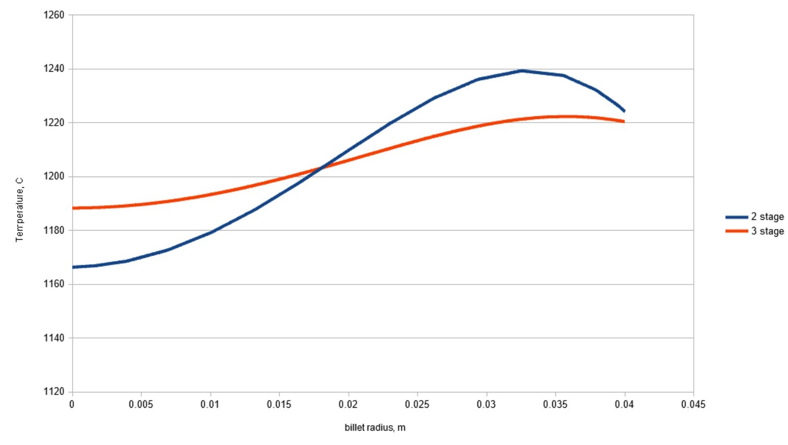

Figure 1. Temperature distribution along the billet radius at the outlet of the heating system
Figure 2. Temperature distribution in the long billet during scanning (progressive) induction heating.
Figure 2 shows how different systems lead to different temperature distribution. In the two-stage system, the temperature required for forging is reached with shorter coils, thus also with smaller scanning speed. This leads to worsened temperature uniformity and smaller production rates. On the other hand, the three-stage system heater gradually increases the temperature of the billet and the resulting temperature difference between core and surface is smaller.
