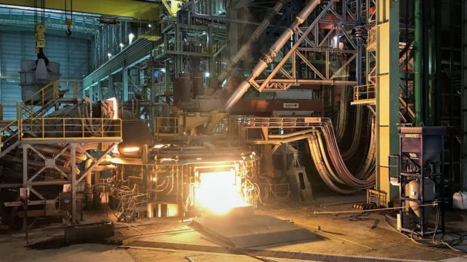

  2. Tenova will supply a second Electric Arc Furnace (EAF) to Tosyali Algeria.
