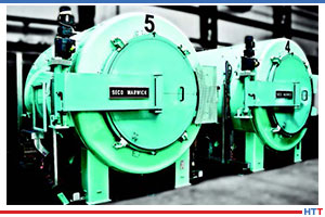

Heat Treat Operations Modernize with 9 Hardening Furnaces
Nine heat treat furnaces are set to modernize the operations of a manufacturer’s heat treat facilities. This move is intended to create cleaner, safer, more cost-effective operations while also allowing for finer process control and a reduced carbon footprint.
The nine furnaces are being fabricated by SECO/VACUUM, a division of SECO/WARWICK Group: three Vector® vacuum furnaces and six tempering furnaces with supporting auxiliary systems. This returning heat treat client currently operates twelve SECO/VACUUM furnaces at their various locations throughout North America. They will incorporate the new furnaces as a continuation of their strategic planning to modernize all facilities from atmospheric heat treatment to vacuum processes.
Piotr Zawistowski
Managing Director
SECO/VACUUM TECHNOLOGIES, USA
Source: SECO/WARWICK
Each of the nine units are front-loading, horizontally configured furnaces with a 36″ x 36″ x 48″ working volume and a 3300 lb. capacity. The Vector® is a single-chamber gas quenching vacuum furnace using high pressure quench (2 to 25 bar) which can be applied to a variety of heat treating processes and applications. These particular Vectors will be used primarily for hardening. Tempering is a process primarily used to increase the toughness of hardened ferrous-alloy parts. The tempering process is typically applied after a hardening process.
Heat treating operations will have to shut down entirely during the modernization changeover. To minimize disruption, SECO/VACUUM will also serve as the general contractor, overseeing the installation of the new furnaces, auxiliary systems, wiring, piping, and ventilation needed prior to commissioning and operator training.
“It is a testament to our commitment to our partner’s success that they not only continue to return for more furnaces, but that they place their trust us in to manage the entire project in order to get them back to serving their customers,” said Piotr Zawistowski, managing director at SECO/VACUUM.
Heat Treat Operations Modernize with 9 Hardening Furnaces Read More »

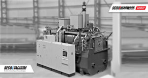

US Defense Contractor to Receive Vacuum Oil Quenching Furnace
HTD Size-PR Logo
Piotr Zawistowski
Managing Director
Source: secowarwick.com
A new vacuum furnace for a division of the US Department of Defense will bolster its capability to ensure supply chain reliability. The furnace is equipped to handle steel hardening, surface engineering, vacuum annealing, nickel alloy processing, and titanium heat treatment.
As a critical supplier of aerospace components to the US Department of Defense, this division will use the new vacuum oil quenching furnace, provided by SECO/WARWICK, Group, to handle functions of the department’s existing heat treatment furnaces and expand their capabilities. The addition of low pressure carburizing (LPC) and high pressure gas quenching (HPGQ) is new to this location.
“Assuring redundancy in heating needs of this location was critical,” said Piotr Zawistowski, Managing Director of SECO/VACUUM.
US Defense Contractor to Receive Vacuum Oil Quenching Furnace Read More »
