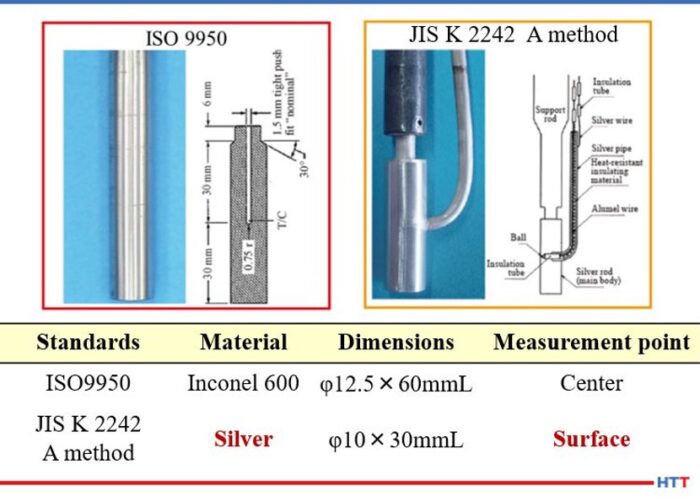

Cooling curve
There are many different methods of running a cooling curve. Many Asian suppliers of quench oil will use the Japanese Industrial Standard (JIS) K 2242.  European suppliers will use the ISO 9950 and North American suppliers rely on the ASTM D 6200 method.  All of these standards measure the same basic property, the ability of an oil to reach martensite formation.  However, they differ in one basic item.  The JIS K-2242 and methods used in China and France use a 99.99% silver probe that is smaller than the size of the Inconel probe used in the ASTM and ISO methods of Europe and North America.  Because of this difference, it is important to note that cooling curves and cooling rates between the methods should not be compared.  Figure # 2 shows the comparison between the two probes and their dimensions.
Figure # 2. ASTM D-6200/ ISO- 9950 and JIS K 2242 quenchometer probes^2
ISO/ASTM Inconel probe 12.5mm x 60mm.
JIS K 2242 Silver probe 10mm x 30 mm
In addition to comparing the cooling curve against the standard for the quench oil used, the Grossman H value should also be calculated and used as an indicator of cooling performance.  Unlike the old GM nickel ball test that tracked the time to cool a 12mm nickel ball to 352°C, the Grossman H value measures the severity of the quench6.
