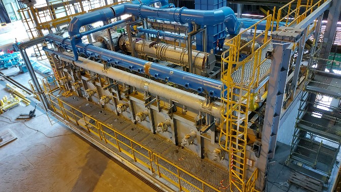

  1. A leading Chinese manufacturer of aluminum plate and bar heat exchangers ordered a semi-continuous Active Only® furnace from SECO/WARWICK.
  2. Ipsen recently installed a second Turbo2Treater vacuum furnace at Temprasud, a commercial heat treater in Fresagrandinaria, Italy.
  3. Tenova was awarded two contracts by Tenaris for its mill in Dalmine, Italy. Both contracts are related to the steelmaker’s new investment in special steel production. The two companies belong to the Techint Group.

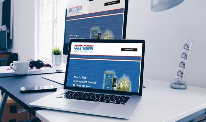

  1. Oxy-Gon Industries announced the launch of their new website, designed in collaboration with research universities, government R&D, and other client partners.

op-edWe will explore the ever-popular subject of how to make money the easy way. Well, better stated: How to save some money, but at the end of the year the result is the same.
This column is a Combustion Corner feature written by John Clarke, technical director at Helios Electric Corporation, and appeared in June 2022 Heat Treat Buyers Guide print edition.
John B. Clarke
Technical Director
For our discussions, we will assume that we are operating a continuous heat treat furnace that processes work at 1600°F. The furnace currently consumes 2,000 SCFH of 1000 BTU/SCF natural gas and operates 8,000 hours per year. With today’s natural gas at 8.00 USD per 1 mmBTU (1 mmBTU = 1,000 SCF of natural gas), our furnace’s annual operating cost is:
Using our trusty combustion analyzer that provides a readout of the oxygen present in the flue products, we quickly determine the fuel contains 6% O2 (measured by volume, dry basis). The “volume/dry basis” is the most common value measured by handheld combustion analyzers. We measure the temperature of the flue products at 1700°F. Our burner and/or furnace specifications say the system should be operated at 3% O2. How much can we save by adjusting the burner(s) on this furnace?
Table 1 below provides savings numbers that result when non-recuperated burners are returned to 3% O2.
If we read where the exhaust temperature row intersects with our column for our starting O2 volume in the flue products, we see the resultant savings will be 13.9%:
We chose 3% O2 in the flue products (around 15% excess air) because radiant tubes and direct fired systems can commonly operate at this level with little CO or soot generation. A simple combustion analyzer can be purchased for a few thousand dollars and the labor required to make these adjustments is generally under a day. The payback period for this maintenance investment is measured in weeks, even if it requires the purchase of new tools.
There may be an added benefit we receive when adjusting the furnace. We may have an opportunity to increase the throughput, so perhaps production can be increased while fuel costs are reduced.
Table 1 can be used for other specific conditions, so keep it handy. Next month, we will explore the savings resulting from recuperation or pre-heating the air.
Recuperation projects are more complicated and require greater investments, but they are becoming increasingly critical for heat treaters working to stay competitive in our new reality of dramatically higher natural gas prices.

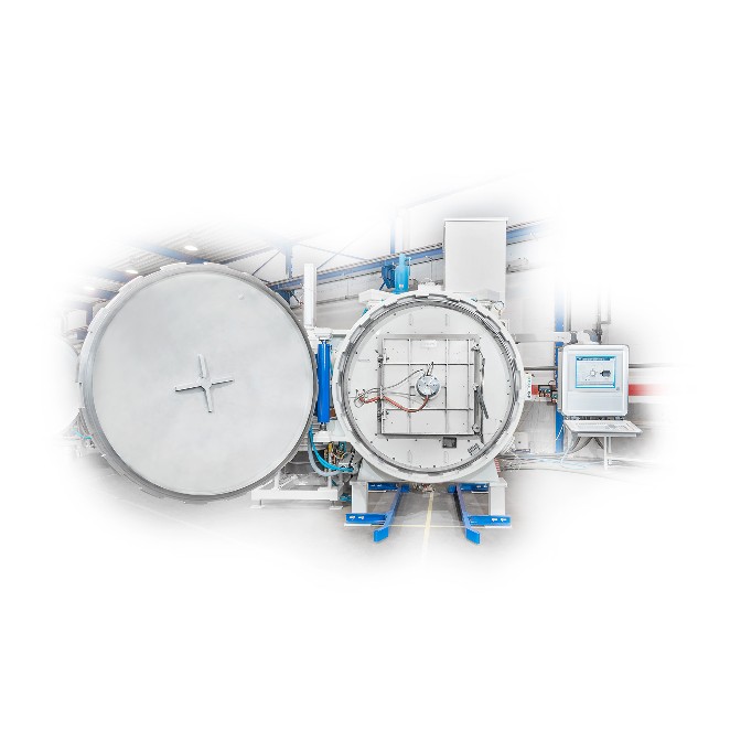

2 Heat Treat Furnaces To Assist CMC Industry
HTD Size-PR LogoTwo atmosphere controlled retort box furnaces will be used for de-bindering ceramic matrix composite parts (CMC) as well as powder metals processing (PM) and hot isostatic pressing (HIP).
The main function of this L&L Special Furnace Co., Inc. furnace is to remove all organics and other materials used in the product prior to placing in a high fire vacuum chamber in a process called de-bindering: Parts are heated to 1220°F in a retort chamber that is pressurized with nitrogen. The by-products of the outgassing part are directed by pressure and flow out the rear of the furnace. The parts are then heated in a vacuum furnace to temperatures in excess of 2300°F. The result is a component that is stronger and lighter than titanium.
Aerospace and military have always been the key areas that CMC and additive technologies are applied. The CMC development is a key part of the subsonic ordnance project along with multitudes of other military applications. This technology allows for lighter and more durable aircraft, munitions, and body armor versus using some alloy and ceramic substitutes. Automotive has also always had a strong presence in the additive manufacturing industry as well.
It is new application areas were CMC technology is starting to shine. CMC technology is beginning to establish a presence in agricultural applications such as water desalinization, power and battery technology in providing lighter fuel cells. This technology will be applied to battery operated transportation vehicles, not only improving transportation capabilities but also lowering greenhouse emissions.
