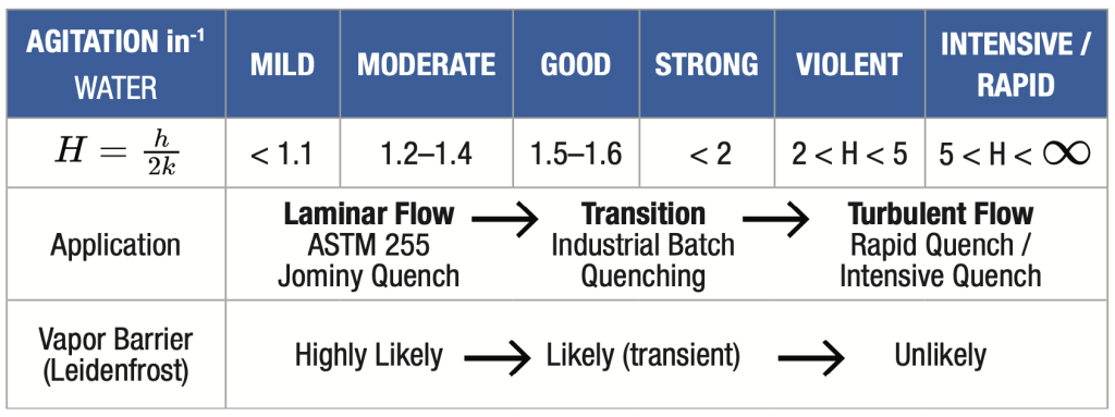

When the Jominy test was developed, quenching technology relied primarily on relatively mild water agitation (Figure 1). Industrial heat treatment has evolved dramatically since then. These advances raise an important question: Does the traditional Jominy test still represent the cooling conditions experienced by modern industrial components?
The answer is both yes and no. The conventional Jominy test remains an outstanding comparative tool because of its simplicity, reproducibility, and enormous historical database (Chandler 1994). However, improved understanding of quench heat transfer — specifically, the laminar umbrella flow underneath rapidly quenched Jominy test ends hides a “film boiling layer” that impedes heat transfer in the first critical seconds of quenching — suggests that the standard unintentionally limits the maximum cooling rate during the first critical seconds of quenching. Consequently, the hardenability curves engineers have relied upon for decades may not fully represent the hardening potential of steels subjected to today’s rapid or intensive quenching processes.

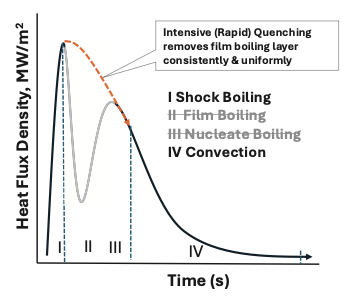

If methods existed to consistently remove the vapor barrier during the first few seconds of quenching, engineers could increase heat transfer substantially (Figure 2) to maximize hardenability. Dr. Nikolai Kobasko and Dr. Michael Aronov have worked at this theory for the last three decades, demonstrating significant material processing benefits with intensive (or rapid) quench practices. Other scientists have also teamed up with heat treaters in the U.S. to demonstrate commercial adoption of industrial parts (Totten, et al. 2024).
Today, intensive quench practices are being seriously assessed by several automotive manufacturers as a way to not only maximize hardenability, but also to control distortion after quenching, impart beneficial compressive stresses below the surface, and reduce spotty hardness, as well as lower cost and improve sustainability practices by employing lower alloy steels.

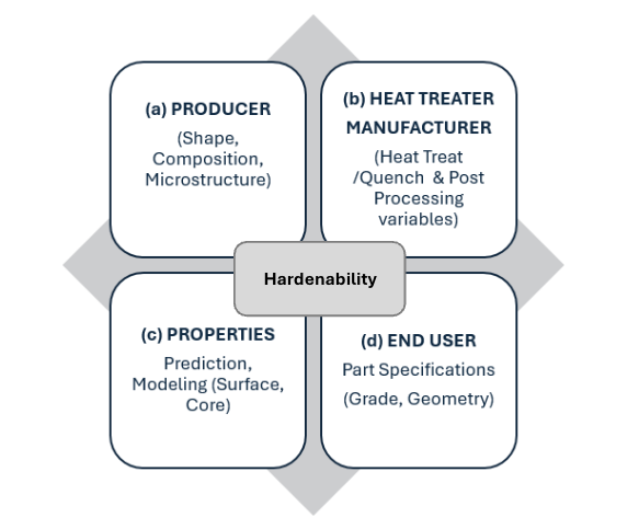

The automotive part production cycle is complex and requires close coordination across multiple stakeholders to achieve desired property outcomes (Figure 3). Designers often rely on “real test” data as input to finite element models to predict critical mechanical properties that correlate with structural life for fatigue, wear, or fracture resistance, with most of these parts being heat treated. They also lean on the correlating structure properties for required parts using the universal ASTM A255 Jominy test as a reference. While this serves as a unique fingerprint for the alloy used, it is by no means an ideal representation of hardenability because chemistry variations that result in a large H-band (Figure 4a).

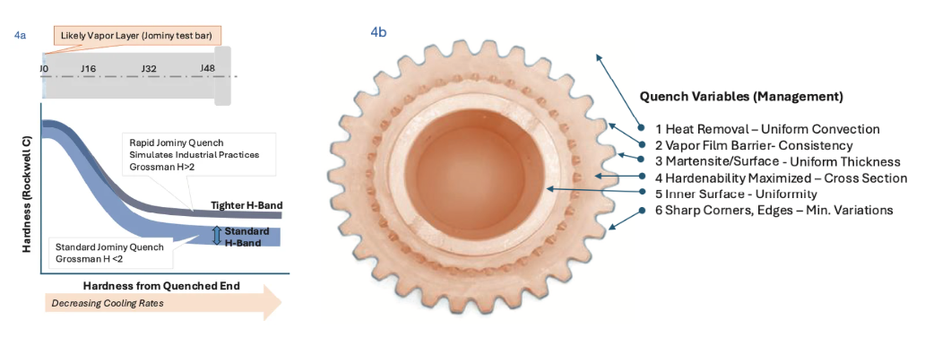

This approach also falls short because Jominy cooling rates do not reflect real-world quenching, which can be seen as enhanced hardenability under industrial conditions (Figure 4b). Heat treaters use high-velocity forced convective flow to create violent agitation, improve quench consistency, increase hardness, and break up the film boiling layer. However, complex parts like gears pose an issue: it is difficult to guarantee uniformity of instantaneous cooling rates and may only break up parts of the persistent vapor layer (Figure 4b). The result is uneven heat transfer and spotty hardness across the part.
Automotive part designers need consistent hardness to ensure reliable service and accurate life predictions, but industrial quench conditions do not ensure 100% removal of the vapor barrier. To ensure performance, automotive designers specify higher alloy steels than necessary. In addition, engineering drawings often specify suboptimal surface hardness (suboptimal hardenability) to stay within hardenability realities of accepted heat treatments. Increased costs are often necessary if parts do not hit design targets and require secondary processing (e.g., tempering, carburizing, carbonitriding).

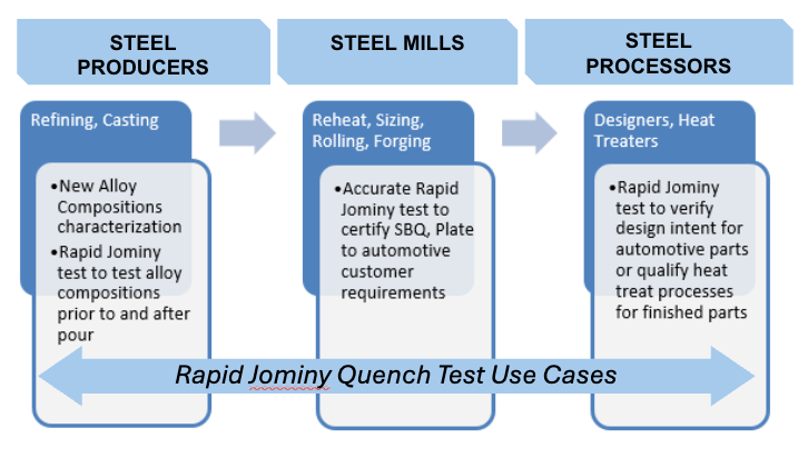

The good news is that we have standard methods characterizing hardenability that are well-established and reliable for thousands of grades of steel. For rapid quenching to be acceptable, we need to reduce risk and increase accountability across the supply chain. One way is to extend the current ASTM A225 standard Jominy test used by all (Figure 5) and use proven strategies that flat steel producers used to implement ultrahigh strength designs in steel.

In short, rapid quenching uses high-pressure, high-velocity water impingement to disrupt the vapor film almost immediately. This allows the surface to transition quickly into nucleate boiling and forced convection, dramatically increasing heat transfer.

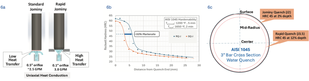

The Jominy test can track the improved hardenability results, if we can make a slight modification to the ASTM 255 test bar design. The modified Jominy test’s critical feature is a flat, tapered configuration versus the traditional flat end face (Figure 6a), and it ensures that the standard uniaxial quench condition is imposed when the bar is sealed in an enclosed chamber. This refinement improves flow control for consistent and repeatable results, therefore providing better alignment with standardized quench conditions used in industry. Another test bar version with a bar end was developed through a university-industry collaborative venture that is useful to measure enhanced compressive stresses (Funk 2021).
The modified bar has been proven to be a close twin of the standard 1-inch diameter bar. The current setup uses a high-pressure nozzle to break up the vapor layer similar to industrial quench conditions and is noticeably different from the laminar flow (H < 1.4) used in the ASTM A225 test. The flow conditions (velocities > 40 m/s, pressures > 120 kPa) have been optimized to ensure that the persistent vapor barrier never forms, achieving high heat transfer rates (H > 5) from the start of quenching till the end of the cooling period.
As a result, current low alloy automotive grades can be quickly analyzed and compared for properties as well as depth of hardening to published hardenability curves, allowing a useful screening tool for adoption.
If heat treaters and steelmakers want to cater to automotive clients who want to reap the benefits of rapid quenching, they need to understand whether their grades are suitable. The simplest approach is to use the rapid quench methodology that has been described here for low alloy steels of interest. This will ensure that true and maximized hardenability data can be used by design engineers to optimize automotive steel parts.
In a recent research study (Nadkarni, et al. 2025), both standard hardenability and true (enhanced) hardenability curves were developed for a benchmark AISI 1045 grade (Figure 6b). The 50% martensite line (45 HRC) is clearly deeper, indicating a significant increase in hardenability, with corresponding Jominy (J in 1/16″) distances moving from J2 to J3.5 (from 3.2 mm to 5.5 mm). An example of how the data can be used practically for a sample 3-inch bar shows that depth of hardening to HRC45 is likely to be significantly higher in rapidly quenched steels (Figure 6c).
The increased hardenability results shown for the benchmark AISI 1045 have been replicated for a wide variety of steels including AISI 1020, AISI 8620, AISI 6150, M50, and tool steels like H13. However, we need to be cautious about extrapolating the results to steels where significant retained austenite can form under enhanced quench conditions.
