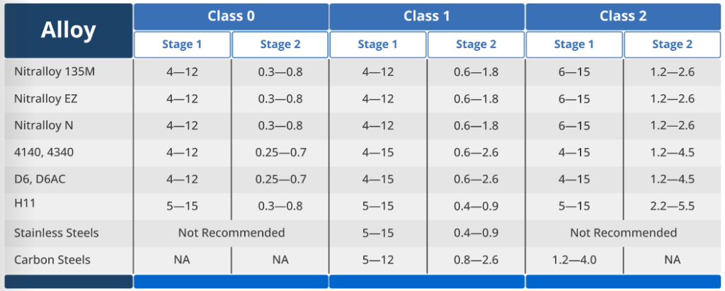

Notes:
1. Class 0: No white layer permitted on the surface of a nitrided part.
2. Class 1: 0.0127 mm (0.0005 inches) maximum white layer, 15% porosity or less.
3. Class 2: 0.0254 mm (0.001 inches) maximum white layer, 10%–50% porosity of the thickness of the white layer.
Dimensional change in nitriding is primarily governed by composition, tempering temperatures, time/temperature of nitriding, relative thickness of case/core, shape of the part, and areas masked off to prevent nitriding. The amount of growth is typically constant for identical parts nitrided in different batches by a fixed processing cycle. Most parts are nitrided in a two- or three-stage process and not ground after nitriding (Table A). This affords them excellent dimensional stability (Herring 2011). Once the amount of growth for a particular part has been established, allowances can be made during final machining (prior to nitriding) to ensure repeatable results.

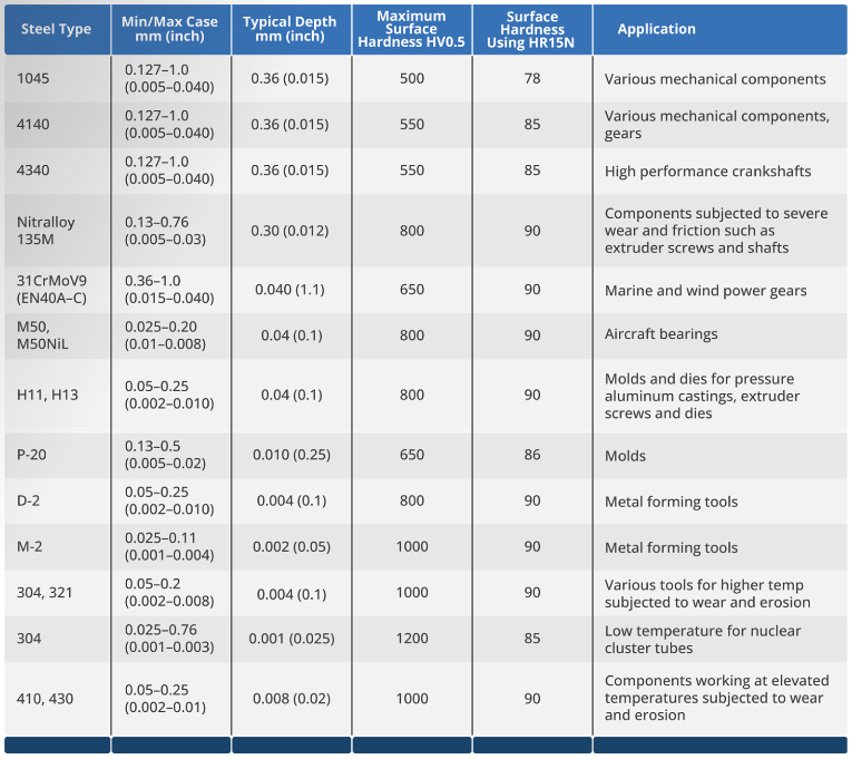

#2 Case Depth Control
Nitriding as a thermochemical process is capable of producing a variety of case depths, an attribute affected by temperature, time, and nitriding potential (if there is not a compound zone formed). Caution should be used when stating a required case depth since a number of definitions for total case depth are in use. For this article, authors will use Table B to show how case depths are typically total case depths (core hardness + 50 HV0.5) that vary by material.
For example, on an M2 tool steel, the case depth might vary between 25–100 µm (0.001”–0.004”). By contrast, 4140 or Nitralloy® can produce case depths in ranging from 100–500 µm (0.004–0.020”), with 305–380 µm (0.012–0.015”) being typical. For low/medium carbon steels and powder metal, white layer thickness may vary from 5µm–25 µm (0.0002”–0.001”) and is the overriding consideration.

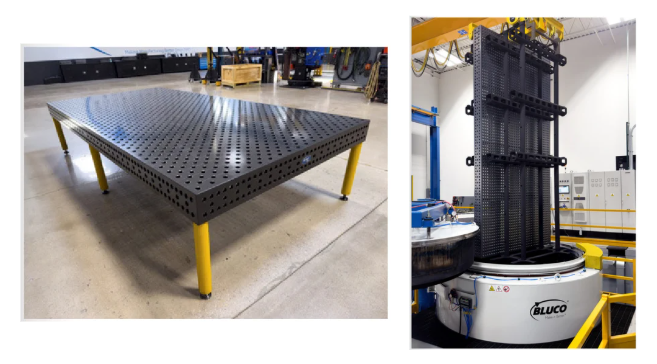

The nitriding process can be used for surface hardening of both very small and very large parts (see lead image above and Figure 1). Typical examples are gears and shafts, stamping dies, piston rods, springs, pump housings, and welding tables. Dies are typically made of cast iron or tool steels, while gears and other powertrain components are made of alloy steels. All applications require precise control of the compound zone (i.e., white layer) thickness. If selective nitriding is required, areas are masked using a stop-off paint, or in plasma processes, mechanical masking is an option.

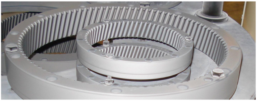

Once finished, nitrided surfaces are typically smooth and grayish in appearance (Figure 2). If a “shiny” or “bright” surface or one of extremely low roughness is required, polishing methods can be used (e.g., superfinishing). The surface has high hardness, and is under residual compressive stress, which is critical in increasing bending fatigue and rolling contact fatigue (RCF) properties.

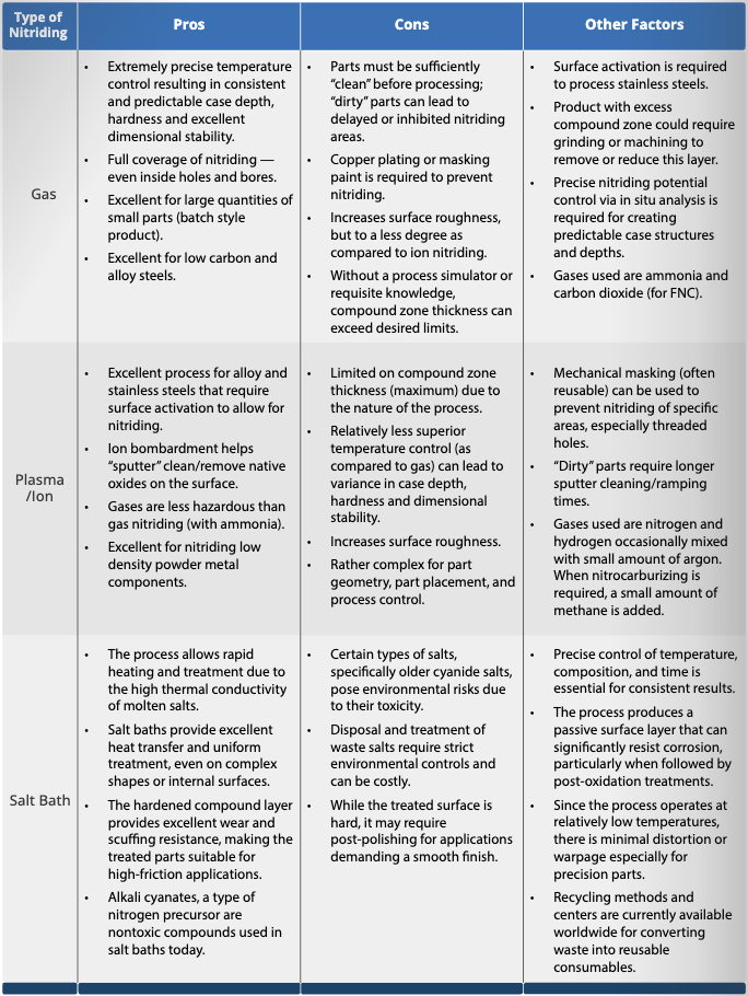

Gas, Plasma, Salt Bath
There are three types of nitriding, each with their own strengths and limitations: gas, plasma/ion, and salt bath. Table C highlights these differences for immediate comparison. For a further breakdown of each process’s strengths, the authors have written unique articles exploring the three processes in greater depth, available on www.heattreattoday.com under each of the names:
Nitriding is a key technology to achieve heat treated results that modern manufacturing expects. But between gas, plasma, and salt bath, there are pros and cons to whichever method is chosen. Engineers need to assess what material needs and process outcomes are most significant to the outcome in order to select the right technology.
