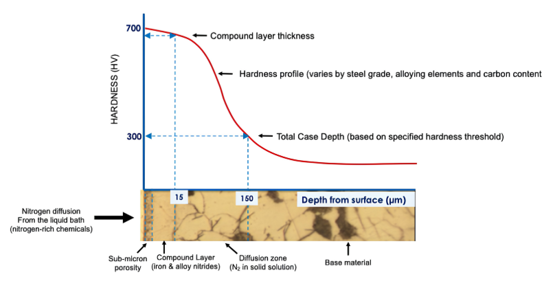

Salt bath nitriding is performed at temperatures typically ranging from 500°C to 630°C (930°F to 1165°F) to produce a controlled and highly uniform release of nitrogen at the surface of the workpiece (Figure 1). Nitrogen diffuses into, and chemically combines with, nitride-forming elements in the metal, producing a tough, ductile compound layer with exceptional mechanical properties through a catalytic reaction. This hard compound layer has wear properties that are reportedly 200% to 1000% greater than the original material, and greatly enhanced resistance to corrosion, galling, and scuffing (Pye, 2003).
Figure 1. Salt bath nitriding modifies the surface metallurgy and properties (“Salt Bath Nitriding, Controlled Liquid Nitriding (Overview),” HEF USA)

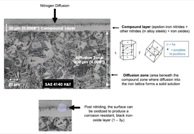

The salt reacts with the metal surface to form a hardened compound layer (primarily composed of ε-iron nitride and γ’-iron nitride) and a diffusion zone beneath it where nitrogen atoms diffuse into the metal matrix (Figure 2).
Figure 2. Microstructure of a sale bath nitrided component (“Salt Bath Nitriding, Controlled Liquid Nitriding (Overview),” HEF USA)

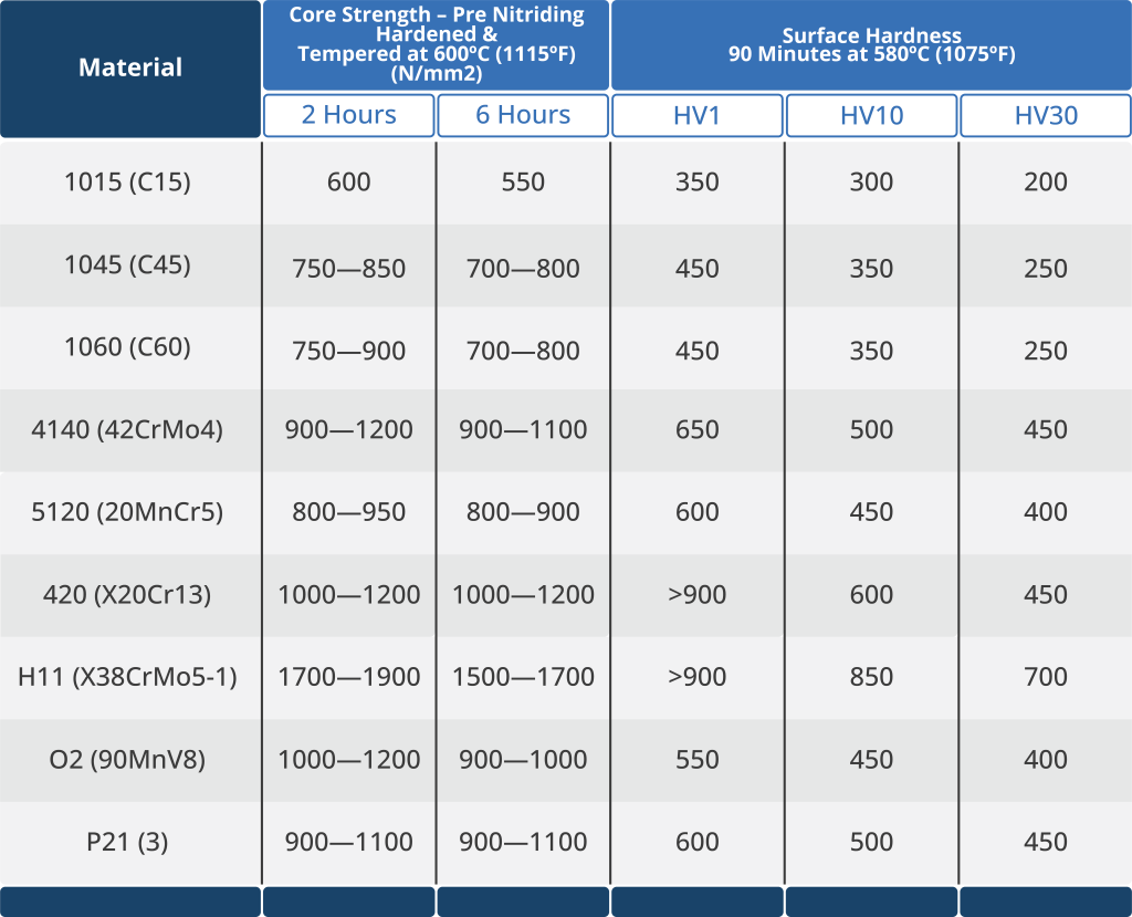

Case depth is a function of both treatment time and material. The final surface hardness is a function of the material composition. Higher percentages of nitride forming elements (Cr, Mo, Al, V, Mn, Ti, W) produce higher surface hardnesses (Table A).
Table A. Surface Hardness as a Function of Material (“Melonite®/QPQ Process,” HEF USA)
