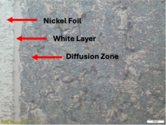

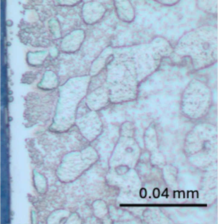

Plasma nitriding can be used over a broad range of heat treating temperatures and is used for all types of ferrous alloys (Figures 1 and 2). Additionally, it has the ability to activate the surfaces of oxidized stainless steels to allow them to be nitrided (Winter and Kalucki 2013; Roliński 1987).
Figure 1. Plasma nitrided A-286 Alloy Marble’s Etchant | Image Credit: The Herring Group, Inc.
Figure 2. Plasma nitrided duplex stainless steel 2205 Marble’s Etchant | Image Credit: The Herring Group, Inc.

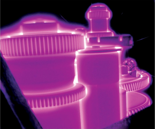

Activation of the surface involves both ion bombardment and sputtering of the surface/cathode in the areas where the glow discharge covers the surface (Figure 3). The actual contact area of the part with the cathodic base plate or fixture does not nitride. The problem of edge effect, which is related to uneven distribution of sputtered atoms at corners and edges of a component (Roliński et al. 2005; Roliński 2024), is addressed primarily by proper adjustment of the processing gas pressure, which changes the thickness of the cathodic glow, making it more uniform around contour of the part. Masking areas that do not need to be hardened is simple. For example, a nut on a thread or a steel plate on a section with small holes is sufficient to protect those surfaces from the glow discharge and prevent nitriding.
Figure 3. Typical “glow” around component parts during plasma nitriding | Image Credit: The Herring Group, Inc.

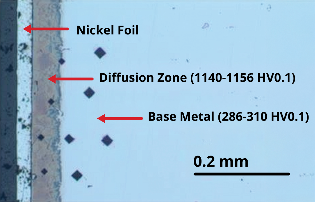

Figure 4. Plasma/Ion nitrided powder metal component run at 565°C (1050°F) in a mixture of nitrogen/hydrogen at a ratio of 1:3 and pressure 3.5 mbar. 3% Nital. (Roliński et al, 2021)
Plasma nitriding is a unique process capable of surface hardening low-density sinter/powder metal (PM) products, even those less than 7.3 g/cm3 (Figure 4) and PM stainless steels (Roliński 2004). This is especially true when a portion of the treated component requires masking (Roliński and Sharp 2005, 2004). Active nitrogen species generated by the glow discharge penetrate only near-surface cavities/porosities, forming a nitrided layer. By contrast, ammonia in gas nitriding penetrates throughout the entire thickness of the component increasing the brittleness of the nitrided part.
