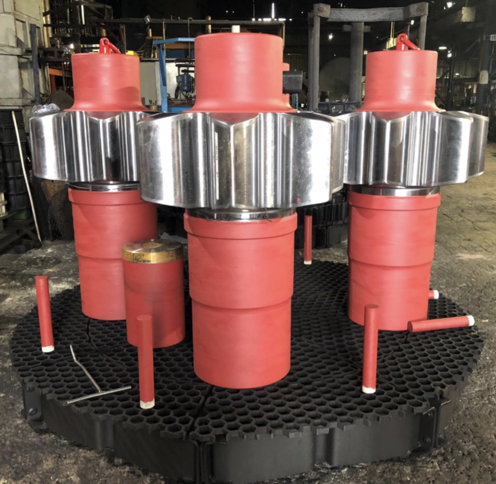

Gas nitriding represents 60–70% of all nitriding processes. The main benefit of gas nitriding, specifically when compared to plasma nitriding, is its ability to harden the entire surface of the component. Masking can be done by copper plating or painting with a nitriding-specific stop-off paint (Figure 1). Modern gas nitriding processes also allow treating of stainless steel, where PVC and other chemicals are used for surface pre-activation. Maintenance increases when these activating agents are used.

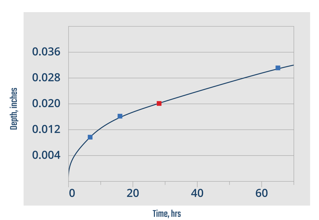

Case depths are typically total case depths (core hardness + 50 HV0.5) and vary by material (see Table B in Herring et al. 2026). Caution should be used when stating a required case depth as a number of definitions for total case depth are in use.

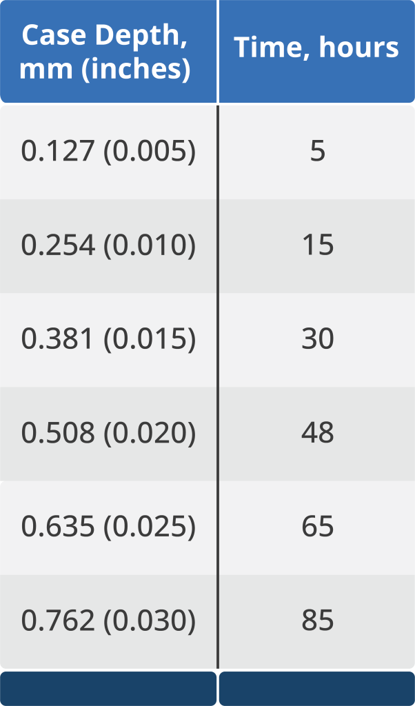

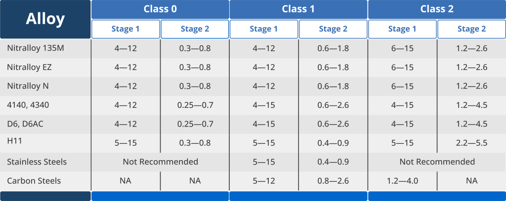

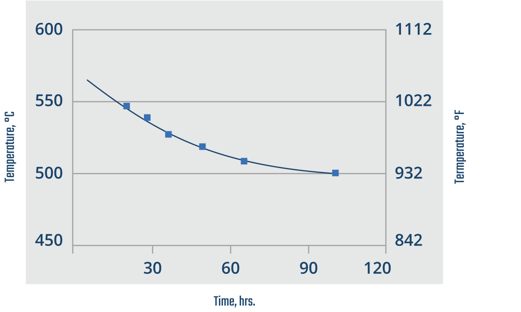

In the single stage process, a temperature range of 500°C–540°C (925°F–1005°F) is typical, and process times range from 1 to 100 hours (Table A). The dissociation rate of ammonia is held in the range of 15% to 30%. The process produces a brittle, nitrogen-rich white layer at the surface comprised of various iron nitrides (Fe2-3N, Fe4N). One advantage of this thick white layer is that it will provide longer component service life in abrasive and adhesive wear applications.
Most parts, however, are nitrided in a two- or even three-stage process and not ground after nitriding (Table C). This affords them excellent dimensional stability (Herring 2011). Case depth is affected by temperature (Figure 3), time (Figure 4), nitriding potential (if there is not a compound zone formed), and how the total case depth is defined.
