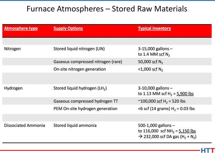

Stored atmosphere raw materials by the numbers
DW:  Getting rid of the need for on-site hazardous material storage is a huge benefit.  That is a major benefit- zero hazardous materials inventory.  Cost predictability is often even more important than having the lowest absolute cost at any point in time.  With hydrogen generation, most of the cost is in the capital and in the electricity that you use to drive the equipment.  So cost predictability is much better, for example, than with ammonia, natural gas, or with delivered hydrogen.
