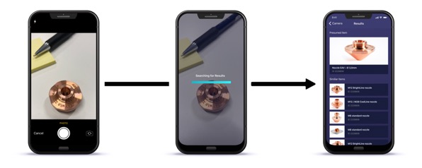

Figure 2. Existing technical solutions for component recognition [Source: Humai Technologies]

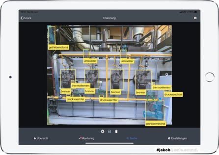

The project team is convinced that the key to success lies in the simplicity of operating the system by using innovative technologies. A conscious decision was made to forge new paths with technology, while remaining down to earth at the same time. Existing solutions for the identification of spare parts or components in mechanical engineering companies from Germany (2017) are primarily based on RFID, bar code, and QR code technologies. Fig. 2 shows that this is only successful in 50 % of the cases, as existing applications such as RFID, bar code, and QR code often do not work in environments with heat, dirt or wear and tear, or for various other reasons. It was also consciously decided not to focus on prestigious eyecatchers such as Augmented Reality Data glasses (Google Glass or Microsoft Hololens), due to two essential reasons: one, the digital maintenance assistance should be easily available and always at hand for all maintenance staff. This could not be guaranteed with expensive and sensitive data glasses. However, almost everyone these days carries a mobile device such as smart phones or tablet computers, regardless of whether running on Android or Apple iOS. (Fig. 3)
Figure 3. Object recognition with standard mobile devices
Moreover, data glasses require perfect data structures (i. e. 3D models of the plants and parts), which has yet to become a standard even in newly built plants in the thermal processing industry. It was decided that the approach would be to only rely on existing data and information in order to equip as many plants as possible – even older ones – with the maintenance assistant and thus be able to provide significant support for the entire hardening industry. In this respect, it can be said that the assistant supports all maintenance staff as a personal assistant and a colleague who is always available.
OBJECT AND SPARE PART RECOGNITION
Figure 4. Example of component identification with AI detection
The assistant breaks new ground in the field of spare parts recognition. Via AI-App on your smart phone, parts and components can be scanned and identified within only a few seconds. The automatic recognition of spare parts saves employees a lot of time. In 2017, it was shown that it takes experts approximately 12 min to find the right spare part in the various documents and systems. The time for such a search will continue to increase in the future, as plants are growing more and more complex and employees are less experienced. The reliable identification of parts paves the way for more information on them. How many times is this specific part installed, what is its article number, how much does it cost, what is the delivery time? The connection with information from procurement history, date of installation and expected mean risk of malfunction provides every part with a résumé (Fig. 4). In a last step, the selected spare/wear part can be placed in a shopping cart for a quotation request.
