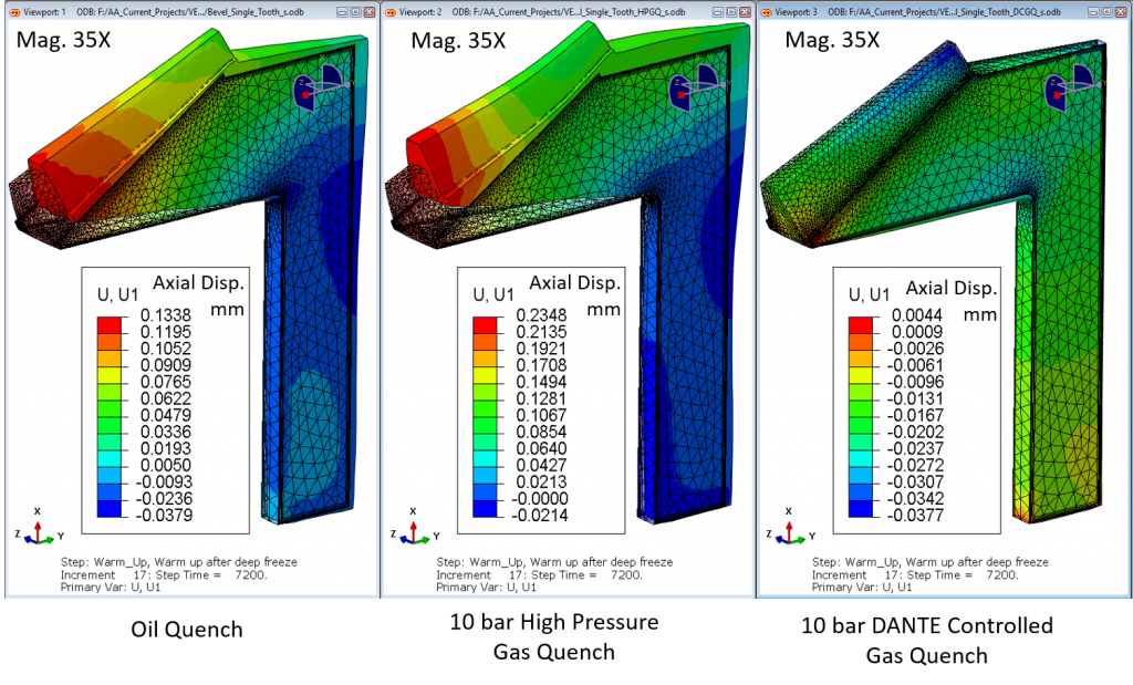

Fig. 1: Bevel gear axial distortion comparison for an oil quench, high pressure gas quench, and a DANTE Controlled Gas Quench

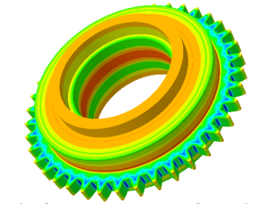

Fig. 3: Minimum Principal stress of a carburized and oil quenched spur gear
