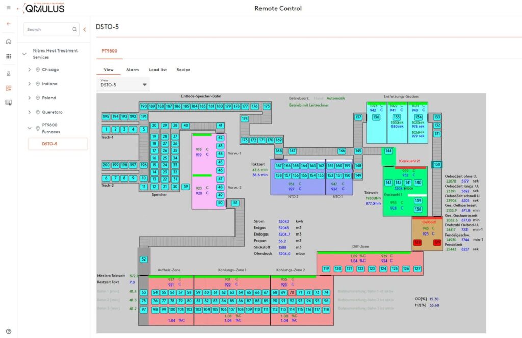

Figure 2. The heart of the IIoT data platform needs to be thoughtfully planned and designed. Illustrated are 5 steps to follow to ensure the cloud data system properly engages with the data generated from your specific heat treat operations, ultimately delivering actionable insights. Step 1 depicts the various data sources; Step 2 shows the data transformation, integration, and processing stages; Step 3 highlights the central QMULUS database where data is indexed and organized; and Steps 4 and 5 demonstrate how data is further processed, distributed, and accessed by different end-users.

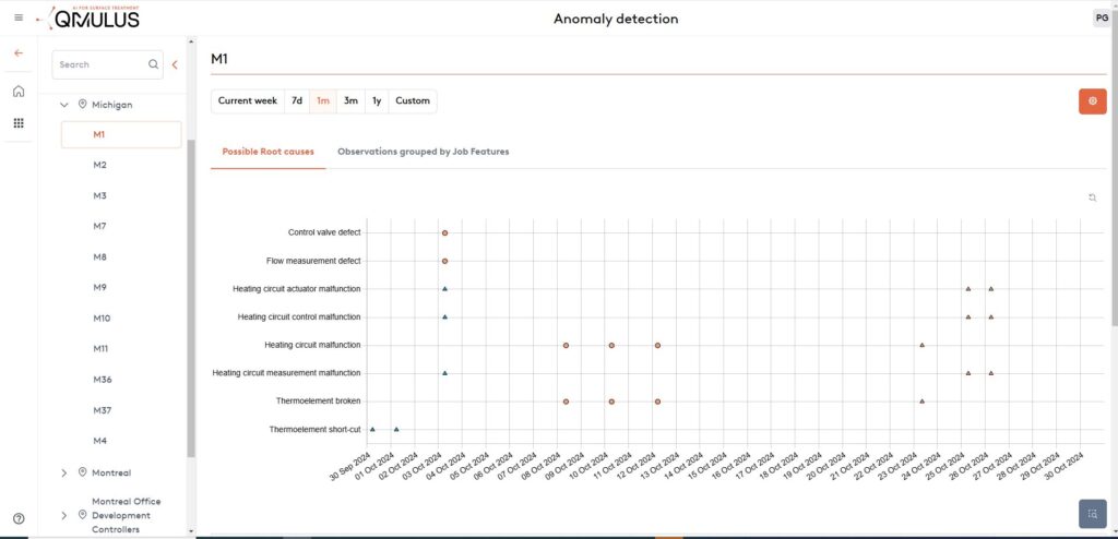

Figure 3. A comprehensive overview displays all detected control loop anomalies, indicating possible root causes as well as recommended actions. Incorporating feedback from the responsible maintenance personnel further improves accuracy and delivers more effective recommendations for future occurrences.
