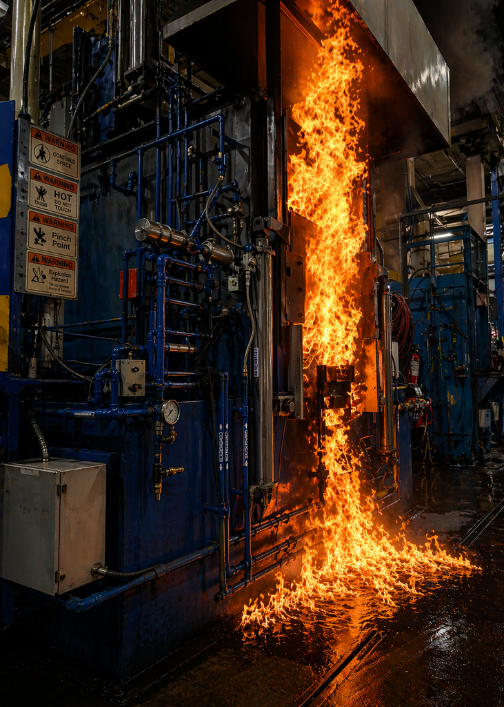

Add water, and you introduce a completely different hazard. It can turn violent before you understand or can react to what you are seeing. In this scenario, when the hot load is submerged, water at the bottom of the tank flashes instantly to steam, expanding roughly 1,600 times in volume. That expansion happens almost instantly, and the resulting increase in volume overwhelms the system.
As the steam rises, each bubble becomes coated with oil. Rapid expansion displaces oil and generates a large volume of vapor in a very short period of time. In a confined quench chamber, that surge carries oil and vapor together toward the burn-off vent and the doors.
There are typically two doors in the system, and they behave very differently. The inner door separates the hot zone from the quench tank. During quenching, the hot zone is typically operating around 1550°F. If oil is forced into the hot zone, it will vaporize and burn, generating products of combustion that can lead to a more severe internal event. However, this is not where the external fire develops. The outer door separates the quench chamber from the outside. During a surge, oil and vapor push upon this door and can be forced out. When the flammable oil vapor and furnace atmosphere reach an ignition source such as the flame curtain pilot, it will ignite violently.
At that point, the fire is no longer confined or controlled. Oil that reaches the exterior can spread along the floor and around the base of the furnace. Once outside the chamber, any oil present becomes fuel, and the fire can spread quickly.

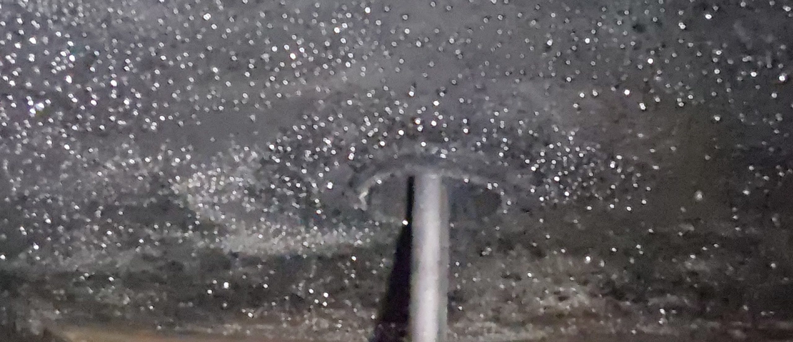

These values apply to dissolved water in the oil — not the free water condition at the bottom of the tank, which is the condition of greatest concern. As the oil cools, its ability to hold moisture decreases. Excess water comes out of solution, forms small droplets, and over time settles to the bottom. This creates stratification — the formation of distinct layers. Oil floats above, leaving a layer of free water at the bottom. That bottom layer is the dangerous condition, the same condition that drives the surge event described earlier.

Most monitoring systems measure dissolved water in circulating oil — not free water at the bottom. That distinction matters. Water that is mixed in the oil can be measured and trended. Water that has separated and settled to the bottom may not be detected by standard sampling methods. A sample taken from a circulating line or mid-depth in the tank can show acceptable results while free water remains undetected. These values are typically determined through lab analysis or in-shop test kits that measure dissolved water in quench oil. Standard tank sampling does not distinguish between dissolved and free water. That is why where you take the sample matters as much as how you test it.
Bottom sampling is critical. Pulling oil from the lowest point in the tank after the furnace has been idle, such as over a weekend, is often the best way to identify free water. If you do not already have a way to sample from the bottom of your tank, you should plan to install a dedicated drain or sample port. A bottom sample should be part of your weekly oil monitoring.
In the absence of a dedicated bottom drain, a simple method can still be used. Tubing can be inserted down through the fill or access point until it reaches the bottom. By sealing the top of the tube, the oil column inside is held in place as it is withdrawn, allowing a sample from the lowest point in the tank. The sample must be taken before any agitation or circulation begins. If the oil has been disturbed, the water can be temporarily mixed and the true condition at the bottom may not be seen.
The sample is placed in a clear glass beaker and allowed to stand. If water is present in any significant amount, it will usually be obvious, especially when compared to a sample taken from mid-depth or circulating oil. If it is not obvious, a crackle test can be used as a quick field check. A small sample of oil is placed on a hot surface, typically around 300–350°F. If free water is present, it flashes to steam and produces visible bubbling or crackling.

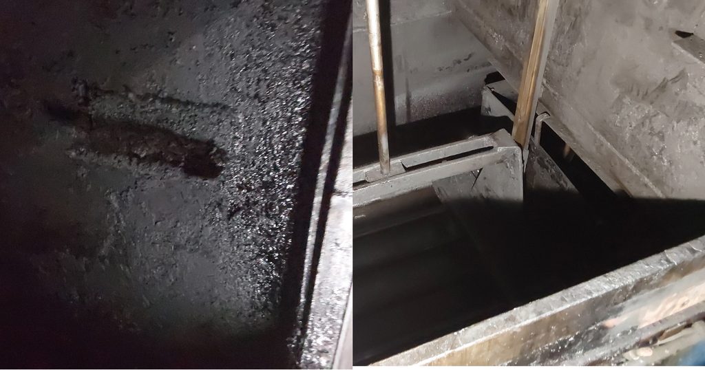

With the oil removed, this is an ideal time to carry out thorough tank cleaning. Over time, quench oils form sludge, a combination of oxidation byproducts, degraded oil, carbon, scale, and fines from processed parts. This material settles to the bottom, can trap and hold water, and hide it from normal sampling. As it builds up, it interferes with oil flow and agitation, affecting quench performance.
