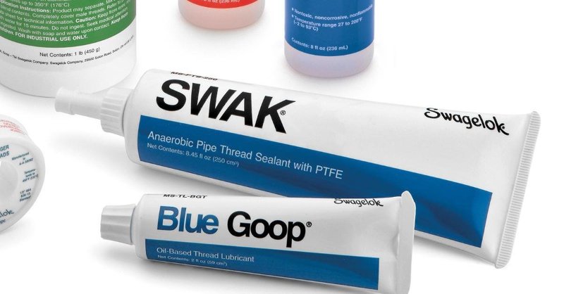

Seal Threaded Connections
SWAK from Swagelok is a great thread sealing option. (photo source: LinkedIn)
Ensure threaded connections have adequate sealing protection on them to prevent air leaks through the threads where applicable. Wipe off excess sealant once the connection is made.
  1. SWAK from Swagelok is excellent
  2. Apply to the male threads only, not on any other surface as it could contaminate the system the component is being installed on.
  3. Excess SWAK can be removed with a solvent such as acetone
  4. Finger tight first, then tighten with a wrench
  5. After the sealant is dry (recommend 24hrs by manufacturer) do not loosen as this could break the seal once cured.
