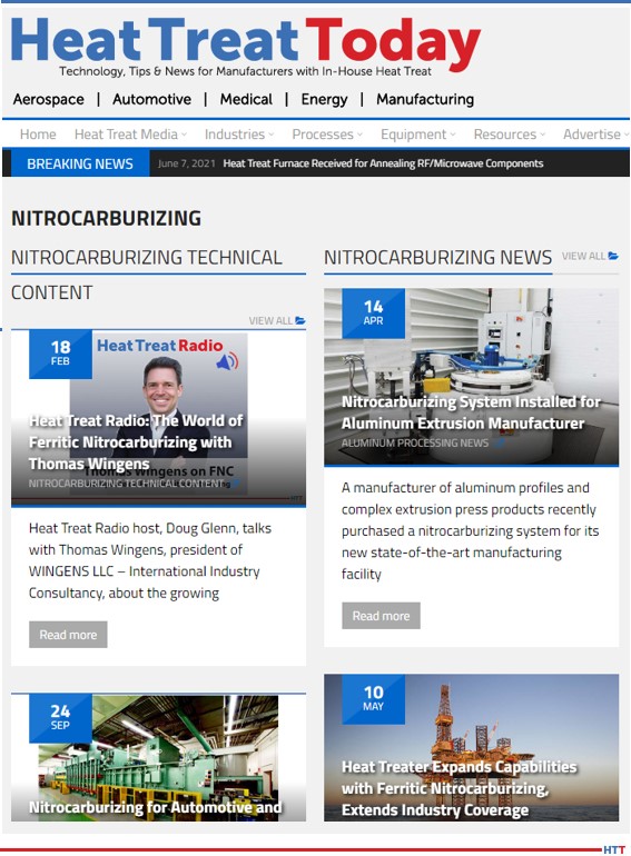

DG:  One other question about nitriding before we move off of that:  Are we seeing that growth in popularity in any particular industries or any particular types of products, or would you classify it as across the board?  You and I have spoken before about brake rotors and things of that sort.
Find out more on nitrocarburizing by clicking the image above.
MH:  It has, you're correct.  They've found new uses for it, and brake rotors are one excellent example.  Whole new companies have emerged just to do that sort of process because of the volumes that are out there.  I think a lot of things are being done.  The nice thing about FNC white layer generation on a part is it also has corrosion control, and for automotive that makes a lot of sense.  They're discovering new uses for FNC.   And then nitriding, in general, has the ability in a lot of instances, as well as FNC, to replace carburizing, depending upon how you engineer the part.  There are a lot of reasons to be using nitriding.

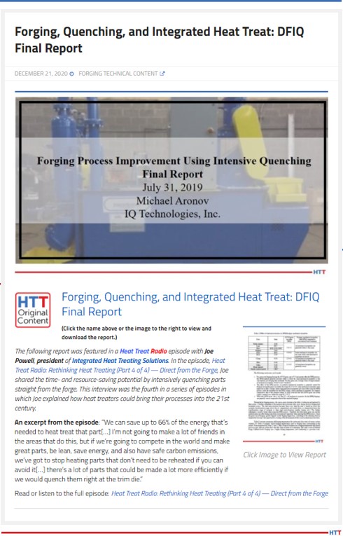

DG:  I want to ask you one last question.  It's kind of unrelated, kind of related, a little bit different.  We had a podcast we did recently, a four part series we did with Joe Powell with Integrated Heat Treat Solutions.  I'm curious your opinion on this.  He talked about this process of basic quenching, getting the whole surface of the part down to the martensite start temp which basically forms a case around the part and then you can, basically, slow conductive cool from the core inside out.  It has to do with hardening, so I wanted to just throw it out to you.  Did you get a chance to listen to those podcasts or parts of them, and what do you think of that whole process?
MH:  I did.  As you requested, I looked at the podcast on intensive quenching by Joe Powell.  I'll tell you that, I actually can't remember which show it was, one of the last or two heat treat shows, I actually ended up sitting next to him out in the hall somewhere and he handed me a piece of paper and said, “Here!  This is what we're doing.”  I was exposed to it before, but I got into it more now that you showed it to me.  It certainly is science based and he understands the issue of quenching very well.  I point out that our 4D Quench solves many of these issues, but he's coming from his angle on it, and I certainly agree with him.
As you may recall, I probably mentioned it before, my father was in the industry and had 65 patents, mostly heat treat related inventions.  Rarely did we make money off of these ideas.  So, I'm used to a lot of great ideas, but you can't make money.  I think it's challenging in this world of mass production heat treating, where we have carburizing being performed at 50 cents a pound to get engineers, like Joe is wanting to do, to focus on the whole part life cycle and combining that final quench phase with the part design.  I think it's a great idea but I just think it's hard to do.
We kind of know this from experience, and I won't get into it too much, but I think you may know that we have a process called PreNite where we prenitride our parts.  That is a similar type thing where we're trying to take advantage of things that we know are possible in heat treating and prenitriding it allows the grains to not grow when you go to higher temperature to try to get more productivity out of a piece of equipment.
The one thing you've got to do, though, is convince the engineer to use a different alloy so that you don't get grain growth in the core.  Convincing those guys is tough.  We just don't see engineers engaged enough to do this complex reengineering.  That's my opinion only.  I think that's where Joe is going to get some resistance.  I think his ideas are great, and of course, I totally agree with his approach to it.  I could go through some other ideas that I came up with just reading his is almost like should you misquench first before you dunk it in the oil so you get that outer case, as he talked about.  I think it's a lot of great of ideas.
What we need to do is find some really good engineers to break the barrier of those low risk takers that we have in engineering, and I think that's possible.  You may know everybody's out there talking to people like Tesla and SpaceX and some aerospace companies.  These guys are starting to break some of these barriers.  They're starting to saying we don't want to do the status quo, we want to do something different.  If we can do that, a lot more of these technologies will take off.
