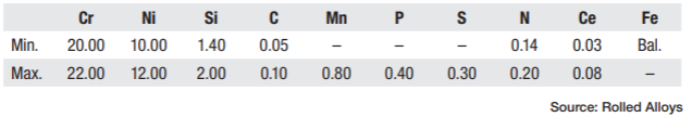

RA 253 MA has a specified chemistry, as indicated in Table A.

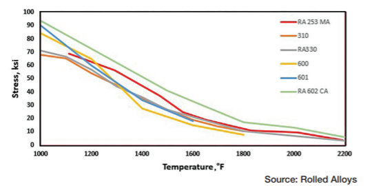

Figure 1 shows the hot tensile strengths of different materials. RA 253 MA can be seen to have higher hot tensile properties than alloy 600, 310 stainless, and RA330® but lower than RA 602 CA®. It’s worth noting that while its hot tensile strength is reported up to 2200°F (1200°C), practical use is limited to 2000°F (1090°C) in oxidizing environments due to a loss of oxidation resistance at this temperature.

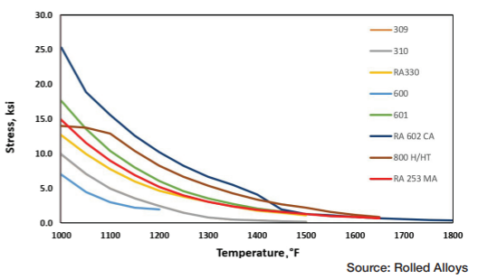

Figure 3 displays the actual 10,000-hour rupture strengths of different high temperature alloys. The data reveal that RA 253 MA exhibits high creep and rupture stress values comparable to alloy 601 and RA 602 CA, and it surpasses RA330; this would also surpass alloy 600.

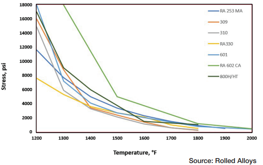

In Figure 4, data are presented for the minimum creep rate of 0.0001% per hour. Creep refers to the rate at which metal stretches, and it is usually measured in percentage per hour. There is a phase where the creep rate remains relatively constant, known as the secondary creep rate. This rate is a key factor in designing for high temperatures. It’s important to consider that metal will creep even under light loads, as the effects of creep can be observed in material with no load other than its own weight. Therefore, in practical applications, a creep criterion is utilized for design purposes.
The furnace industry has traditionally used a design criterion based on the stress required for a minimum creep rate of 1% in 10,000 hours or 0.0001% per hour. The design stress is typically set at a fraction of this value. For one of its criteria, ASME uses 100% of the extrapolated stress for 1% in 100,000 hours (or 0.00001% per hour). It is not recommended to extrapolate stress rupture and creep data to 100,000 hours above 1800°F (980°C). Th is comparison is provided for general guidance only.
Rupture strength is reported as a stress and number of hours. It is the stress required at a specific temperature to break a specimen within a given time. In the furnace industry, a standard criterion for setting design stresses is to use a fraction of the stress that would result in rupture at 10,000 hours. ASME uses the lower of 67% of the extrapolated 100,000 rupture stress or 100% of the extrapolated 1% in 100,000 hours minimum creep rate.

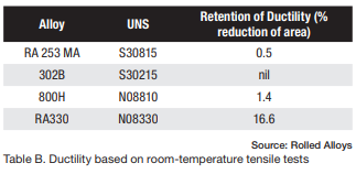

In a simulation where coupons were exposed to fifteen weeks of simulated bake cycles between 1700°F–1950°F (930°C–1065°C) in “green mix” used for producing carbon electrodes, room-temperature tensile tests revealed the ductility as shown in Table B.

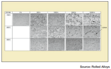

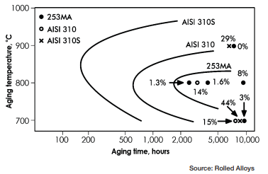

For RA 253 MA, the sigma phase formation process is much slower compared to 310S and 310, as shown in the TTT diagram in Figure 5 and the micrographs in Figure 6. At temperature, it is very unlikely material containing sigma phase will behave adversely. When the material is cooled to room temperature, it becomes very brittle, making it less resistant to thermal cycling. The material may crack if highly constrained and unable to expand freely during subsequent ramp-up.

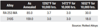

The microstructure of RA 253 MA in the annealed and long-term exposure states is shown in Figure 6. In addition, Table E provides the Charpy impact values for the annealed state and at temperatures of 1292°F, 1472°F, and 1652°F (700°C, 800°C, and 900°C) over a long period of exposure.
Based on the microstructure and Charpy impact data, it is clear that sigma phase precipitation is almost non-existent at 1650°F. Moreover, the TTT diagram in Figure 5 indicates that RA 253 MA requires significantly more time to initiate sigma precipitation compared to 310 and 310S stainless steel.
