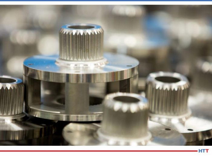

DG:  There are some properties in there that I want to make sure our listeners understand.  You mentioned the idea of hardness and ductility.  Those two things tend to be on opposite ends.  I know there are much more technical descriptions of this, but the harder something is, the more brittle it tends to be, and when it's brittle, it takes less to crack it or break it.  Whereas if it's ductile, it's softer, it can take more of an impact without breaking.  For example, let's just use a gear: On the gear teeth, on the outer edge of the gear, you want that to be very hard so there's good wear, but you don't want it to crack so you keep the inside of that gear, (that's away from the surface side of the gear), soft.  Yes?
MH:  Yes.  And there is a lot that goes into gear design.  You don't want high impacts, obviously, you want the teeth to mesh together.  There are people that induction harden gear teeth, there are people that carburize gear teeth and there are people that nitride gear teeth.  They're all trying to do something on the teeth, and even though you're doing something on the teeth, you still have to also impart certain properties to the core part of the gear itself to make sure that nothing breaks or falls apart on the gear, the main core part of the gear itself.
