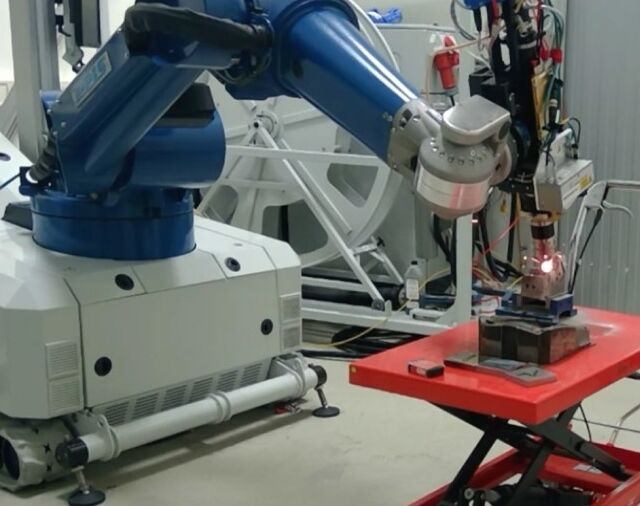

DG: So these are the players. But what about the technology – laser heat treating. Pretty fascinating stuff. Listen as we go back to Andy as he discusses cutting-edge robotics and real-time, feedback-loop pyrometry that makes this laser heat treating system so much different AND BETTER than other laser heat treating systems.
AW: So, I was part of the team that worked on initial startup and all the initial projects associated with the robot and the laser system. Some of the things that set it apart from the traditional lasers and systems that are out in the marketplace now is this has the Fonhoffer Control System so there is onboard optical pyrometry which is a very strong tool for this. A traditional laser is almost like a guess-and-check type of method where you adjust the wattage, see if you achieved the hardness, and in this system, we have the optical pyrometry that has a feedback loop that reads the temperature of the part and then it can control which is really important as a part’s geometry changes. We are going to be able to have better repeatability and control for our customers’ parts. Now, obviously it’s always best if you get one set up part but if the customer just has one part, we are much more likely to get it right and not hurt their part with some of the hazards that could be associated with laser-like melting.
DG: Doug Peters expounded as well on some of the advantages of the Laser Hard heat treating system.
DP: You can locally heat treat parting lines. You can locally heat treat shear areas in a cut off die. You can, instead of having to heat treat the whole part — basically the strength, Doug, is that you can finish a part, we can locally heat treat and then you can put it to work. So the precise heat of a laser enables us to not have to
temper everything. In Europe, as they employ this technology, they don’t temper much, if anything because they don’t need to, because of the way this works. Right now I can tell you that the main strength I see in this thing is the precise placement of the treatment, whether it be cladding or heat treating, and the areas that we can direct the beam that you cannot get at with any other technology or method of heating. So, in other words, if you have a blind hole that is two inches deep, I can put a beam into the bottom of the hole and I can harden just the bottom of the hole, and you can’t do that with induction or flame. And with traditional heat treating you are going to have the hard finish cost associated with the distortion as part of the base heat treating cycle.
DG: With laser, you can get in the hole, do the job, and be done with no additional post treatments.
DP: Exactly. And no post hard finish time either — which is huge. The majority of time in building a tool is generally in hard finish time.

One of the other benefits of this new laser heat treating service being offered by Laser Hard is its portability. Andy Wilkosz commented on the unit’s portability and its potential application in the gear market.
AW: Another powerful aspect of this is we are hoping to really serve the gear market as well. Where in traditional heat treating, what you run is going to be limited on your furnace size. With this robot having the ability to move around — it’s on tank treads — and the range that it can articulate to, you are only limited by what you can get to. So we have the ability to do very, very large parts.
DG: I don’t know if you caught what Andy said. He said that the laser heat treating unit was on “tank treads.” Those tank treads along with a robotic laser heat treating or cladding arm allow the unit to move on-site to where the part is located and once there to move around the part as needed to do whatever process needs done whether it be heat treating or cladding.
As we left the Laser Hard offices and went into the shop to see the unit in action, I asked Chris Learn about the unit’s mobility as well – the ability to take that machine on-site.
CL: So I think the biggest reason for taking this piece of equipment mobile is if the workpiece is too large to transport. Or if it’s too expensive and too risky to transport. So, it’s a very high-cost situation that instead of taking the part here and having us manipulate it here at our shop, even though we have a ten-ton crane, some parts that we deal with are twenty tons, thirty tons. So, it’s a size restriction. Sometimes it’s going to make sense to take this on site.
DG: I next asked Andy to give us a brief explanation of how the unit works. Here’s Andy, and again, please pardon the background noise from the laser welding shop.

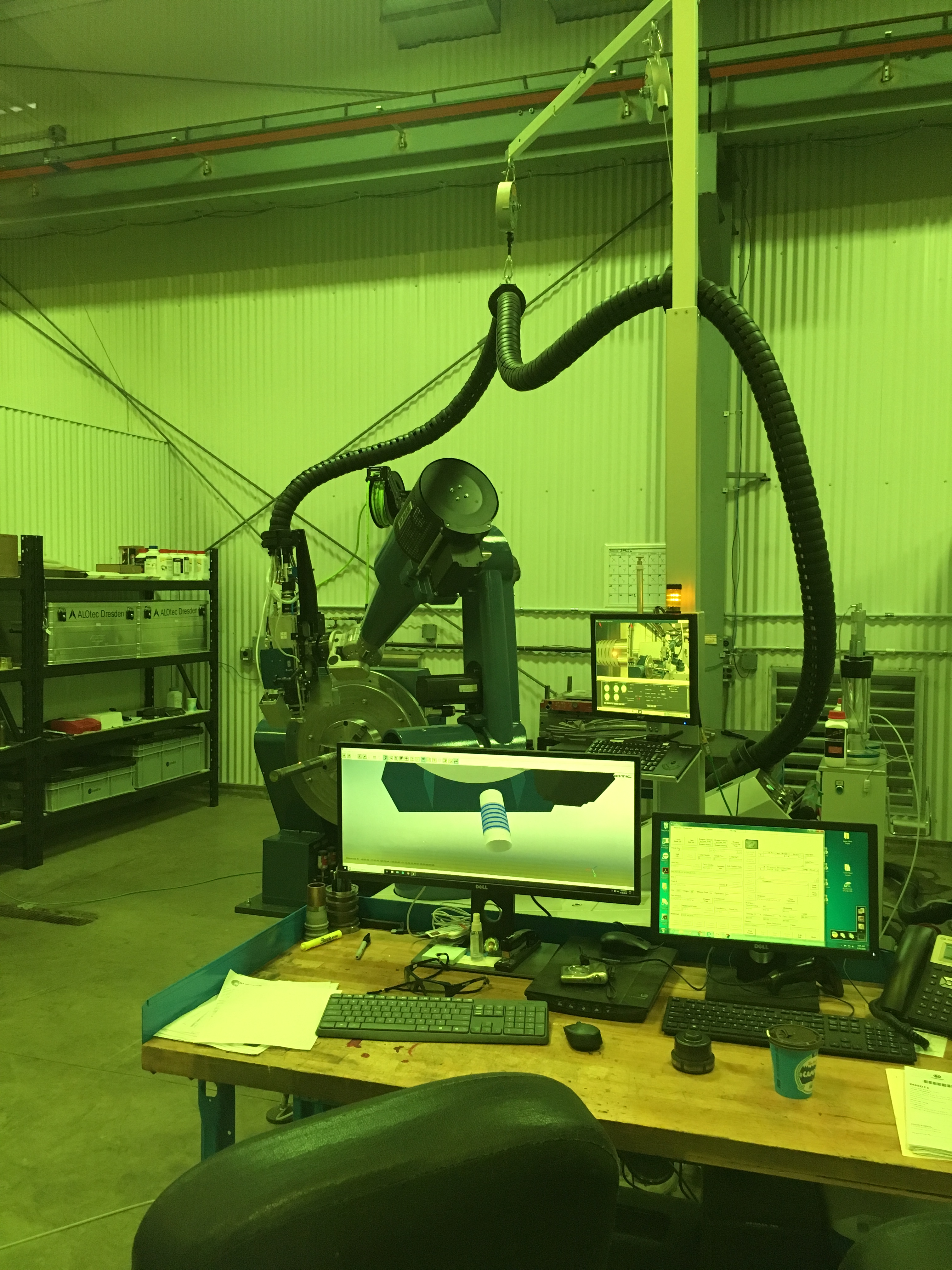

AW: Right now, we have a part chucked up in the rotary axis and with the laser scan technology that we have on the laser, it interfaces with the software on the computer and what Mason can do is, we’ll rotate the part, as he rotates the part, it requires image information through the scan and it will actually build a 3D model of the part and its geometry on the computer. Then once we have that on the computer, we can use the computer to draw and program the path of the heat treat or the laser hardening pattern – whether it be a spot or in this case it’s a round bar and what we are going to do is we are going to traverse the bar in a spiral candy cane/barber pole pattern so that you can harden the entire surface. The beam size is about, the max width is, we’ll say 850,000, it’s a little bit more than that but we’ll use round numbers. So if you want to harden an area larger than that, what you end up doing is making multiple overlapping passes.
