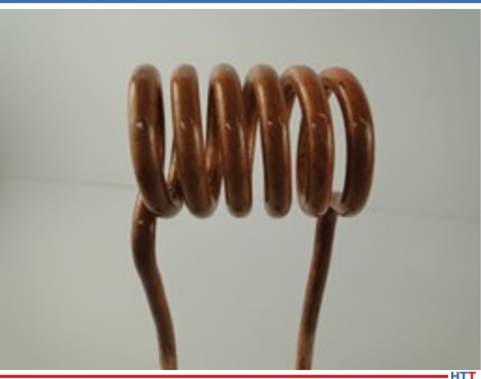

#2 Types of Inductor Designs

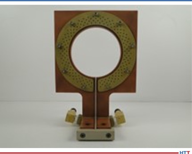

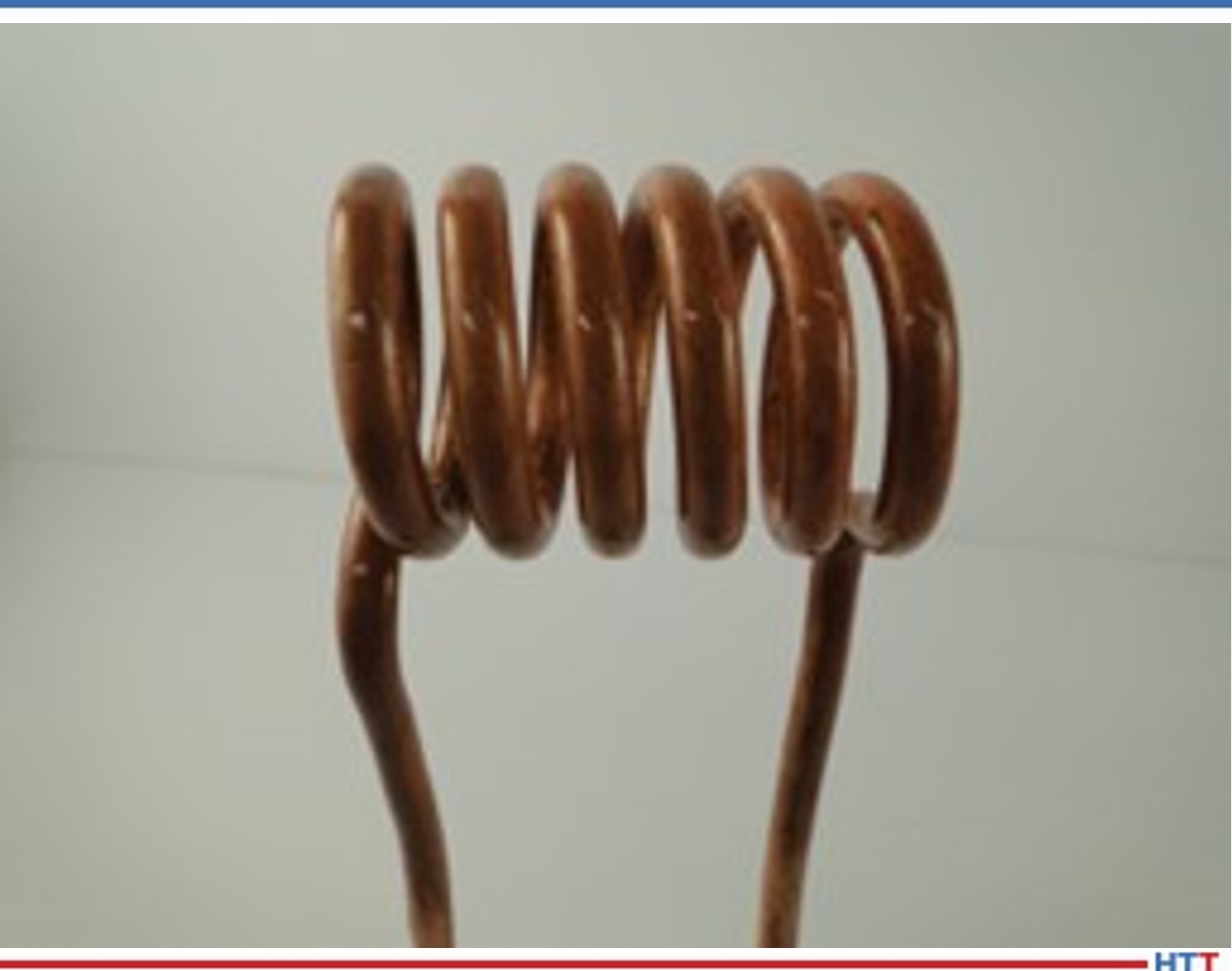

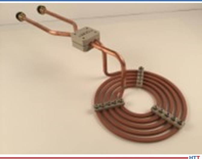

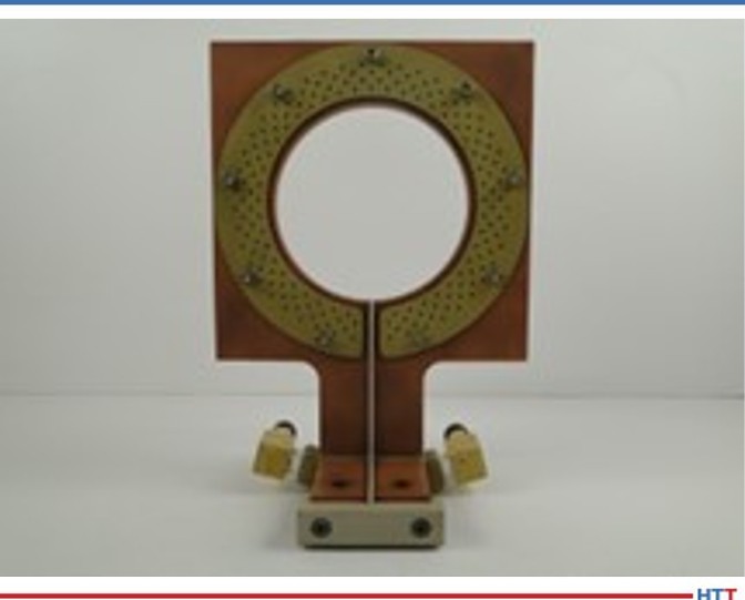

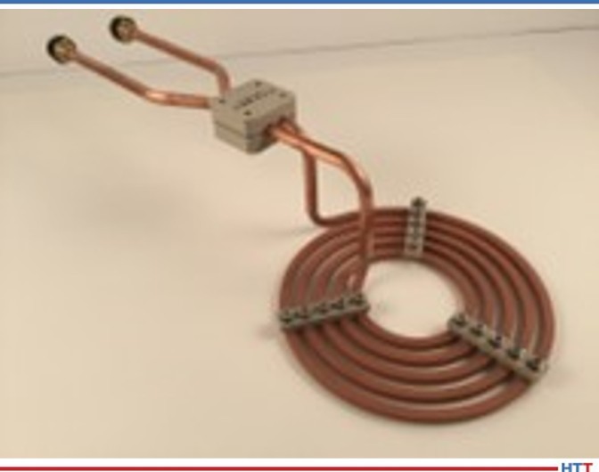

Determining a specific inductor design will be necessary to properly heat parts. The inductor creates the magnetic field in the workpiece, and typically the inductor is shaped to couple closely where heat treatment of the part is desired. Additionally, if quenching is required for the heating application, this function will be considered in the inductor’s design. The inductor’s design must deliver the electrical energy and quench medium to the workpiece while allowing accessibility for material handling purposes. For this reason, inductors take on many different designs.
Photo Source: Induction Tooling, Inc.
Common inductor designs include:
- Pancake: used for heating flat surfaces
- Single turn or multi-turn: commonly shown as copper tubing wrapped around cylindrically around the workpiece
- Hairpin: typically, a simple back and forth loop used to heat long lengths internally or externally on the workpiece
- Split return: used to focus the energy in particular areas of the workpiece
- MIQ (machined integral quench) paddle: the most commonly used design for scanning applications
