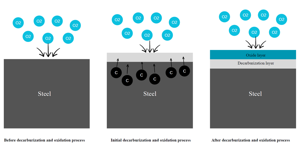

Steel is a solid solution based on iron and carbon, where mechanical properties depend directly on the carbon content and the alloying elements present. Decarburization is a metallurgical phenomenon consisting of the loss of carbon from the surface of steel when it is exposed to high temperatures in atmospheres with oxidizing potential or low carbon potential (Figure 1). This phenomenon commonly occurs during forging, hot rolling, normalizing, annealing, and heat treatment in conventional furnaces without atmosphere control.
From a thermodynamic perspective, decarburization occurs when the chemical potential of carbon in the steel is higher than that of the surrounding environment, which drives carbon diffusion toward the surface. In the presence of oxidizing gases, carbon reacts to form gaseous species:
It can also react with water vapor or carbon dioxide, accelerating the process. As a result, a carbon gradient is generated (surface vs. core), the microstructure is altered, and mechanical properties are degraded, especially at the surface.

Decarburization is closely related to oxidation processes. Oxidation occurs when oxygen reacts with the metal, forming oxides on the surface. This process depends on the thermodynamic equilibrium between the partial pressures of the gases present, which can be analyzed using diagrams such as the Ellingham-Richardson.
An increase in temperature accelerates both oxidation and decarburization, which is why the use of controlled atmosphere furnaces is essential to prevent these phenomena.

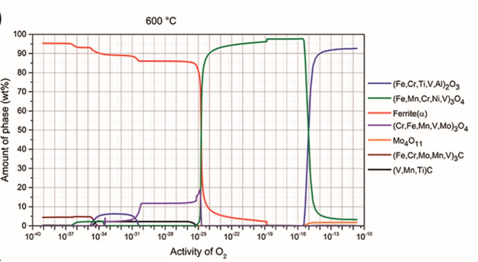

The use of tools like Thermo-Calc software allows the prediction of stable phases as a function of temperature and oxygen partial pressure. These diagrams enable identification of which oxides will form at the surface, evaluation of whether these oxides act as a barrier or facilitate carbon loss, and optimization of heat treatment conditions.
For example, in steels such as H11, phase stability diagrams allow visualization of how oxide formation varies as a function of temperature and oxygen activity (Figure 2). Understanding these relationships is key to preventing decarburization, designing controlled atmospheres, and avoiding undesirable mechanical property outcomes.

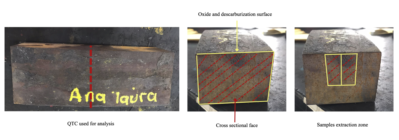

Experimental Methodology

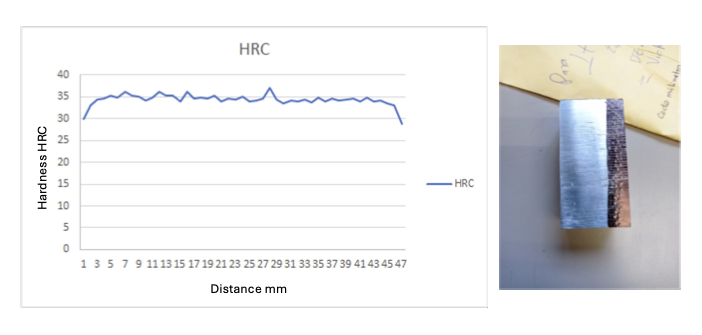

A QTC sample of AISI 4340 steel in forged condition was selected and subjected to normalizing, quenching, and tempering. Samples were obtained through cross-sectional cutting to perform hardness testing, optical microscopy, and carbon chemical analysis (by LECO, Figure 3).
Results
Hardness Profile

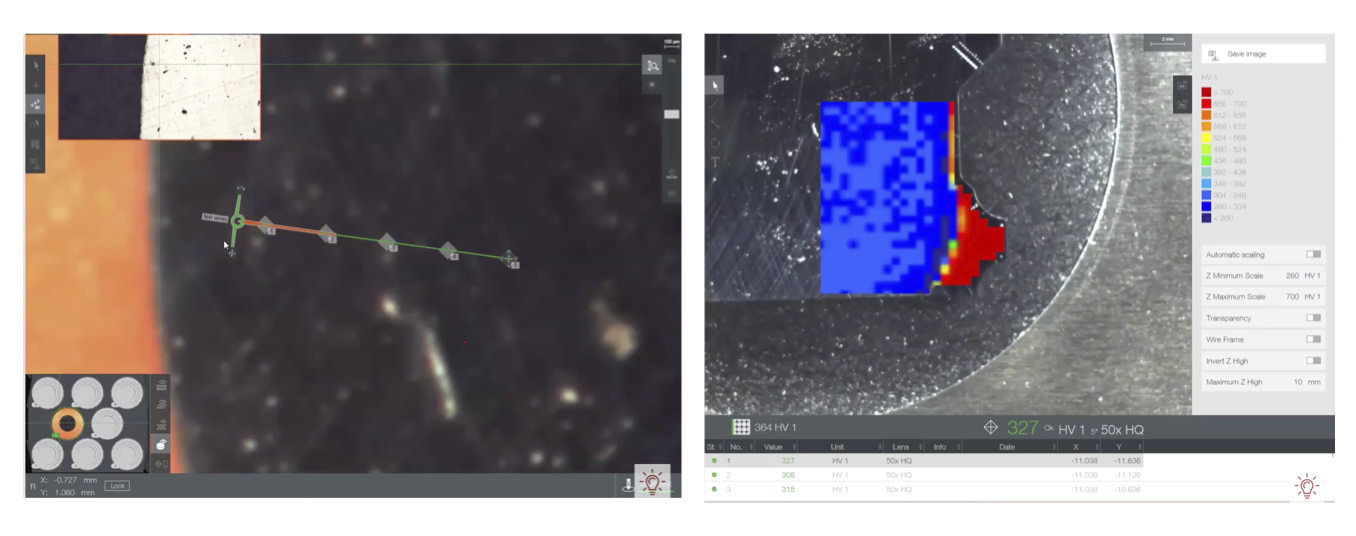

Measurements were taken at 1 mm intervals from the surface toward the interior. The results showed 0–3 mm low hardness values (~30 HRC) and an increase up to 35–36 HRC at 5 mm, remaining constant (Figure 4). This indicates that the surface region does not represent the actual properties of the material.
One of the challenges in this method is the precision of hardness indentations. It can be observed in Figure 4b that a fine marker was used to define the measurement zones; however, nowadays the use of advanced equipment allows automated programming of measurement locations (Figure 5).

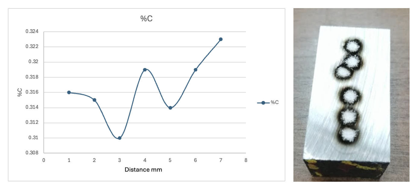

Chemical Analysis (LECO)
The LECO analysis showed an increase in carbon percentage starting at approximately 5 mm depth, confirming the presence of a decarburized layer (Figure 6).

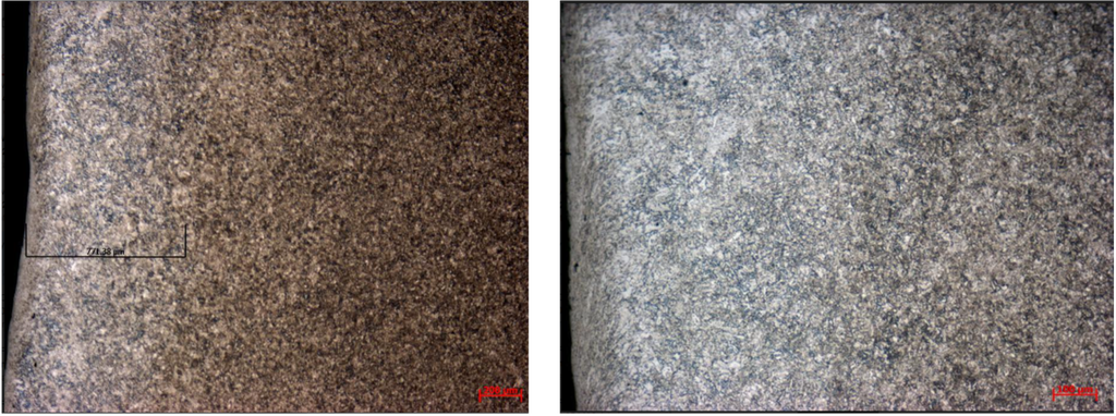

Optical Microscopy
The optical microscopy analysis allowed observing microstructural changes between the surface and the core associated with carbon loss (Figure 7).

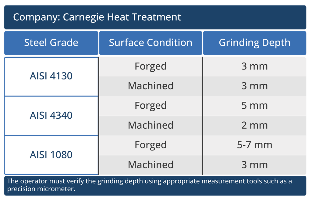

Based on the results, work instructions were established to ensure reliable hardness measurements (Table A).
Operational Implementation
It is essential to involve operational personnel in understanding these phenomena, explaining why proper surface preparation is critical, how it impacts hardness measurement, and how this helps prevent rework. Additionally, it must be considered whether the dimensions of the components allow such preparation. Otherwise, it is necessary to communicate possible deviations or limitations to the client.
This analysis should be conducted for different steel grades, as well as at different temperatures and processing times, in order to estimate the effect on decarburization depth. This will facilitate the implementation of preventive actions for the operational team, instructing them to avoid overheating the parts or exposing them in the furnace for prolonged periods.
It is highly recommended that heat treatment companies conduct this type of metallurgical study, since it allows a deeper understanding of the real behavior of their processes. As previously mentioned, the depth of the decarburized layer is influenced by multiple variables, which may impact each company differently depending on factors such as steel type, furnace type, and processing time, among others.
Based on the results, it is possible to establish clear guidelines for operators, specifically regarding the depth at which samples must be prepared or ground to ensure that hardness values reported to the client are accurate and representative. Likewise, these analyses can be extended to different steel grades, allowing the development of specific work instructions indicating the required grinding depth depending on the material and processing conditions.
