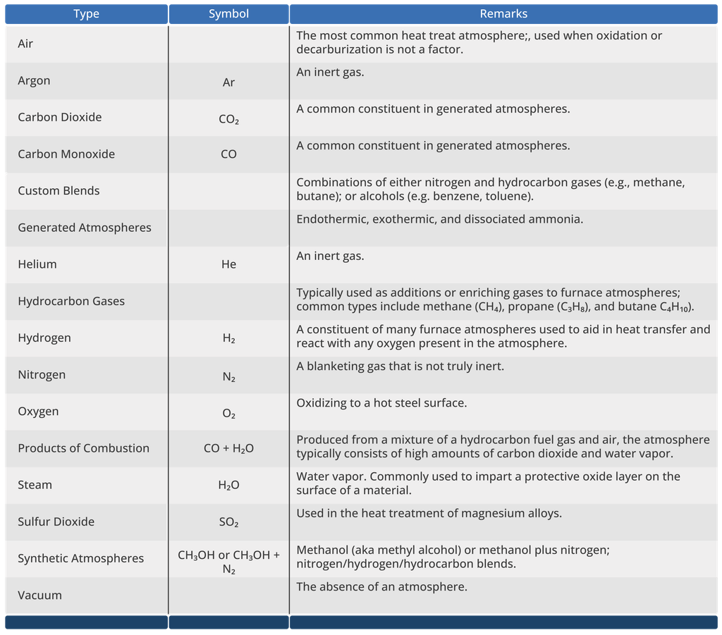

There are many types of furnace atmospheres available for use in heat treating (Table A). By far, one of the most common is endothermic gas.

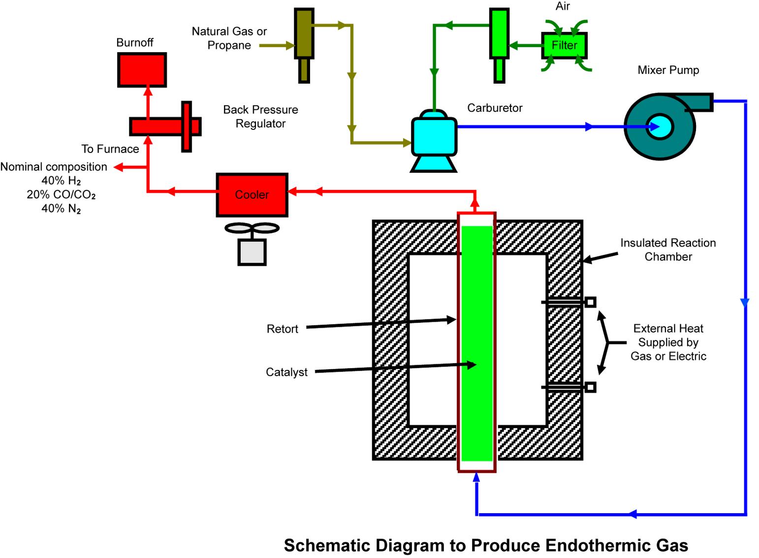

Endothermic gas generators are common equipment in the heat treat shop, with one of the most well-known generators being the RX®. The main components of an endothermic gas generator (Figure 1) are relatively simple, consisting of:
- Heated reaction retort with catalyst
- Air-gas proportioning control components
- Pump to pass the air-gas mixture through the retort
- Cooler to “freeze” the reaction and prevent soot formation

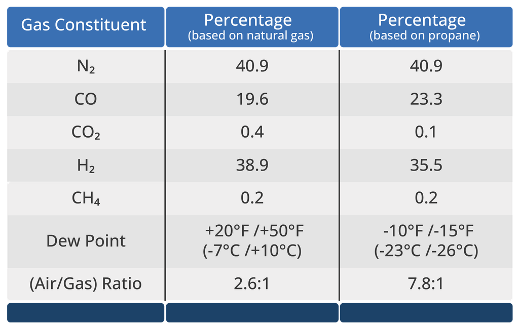

Endothermic gas (aka endo) is produced when a mixture of air and fuel is introduced into an externally heated retort at such a sufficiently low air-to-gas ratio that it will normally not burn. The retort contains an active catalyst, which aids in cracking the mixture. Leaving the retort, the gas is cooled rapidly to avoid carbon reformation (in the form of soot) before it is sent to the furnace. The endothermic gas composition (Table B), by volume, varies depending on the type of hydrocarbon gas feed stock.
Endothermic gas is typically used for applications such as neutral hardening gas carburizing and carbonitriding (as a carrier gas), and for certain types of brazing to name a few. It is generally produced so that its composition is chemically inert to the surface of the steel and can be made chemically active by the addition of enrichment (hydrocarbon) gas that is usually added at the furnace.

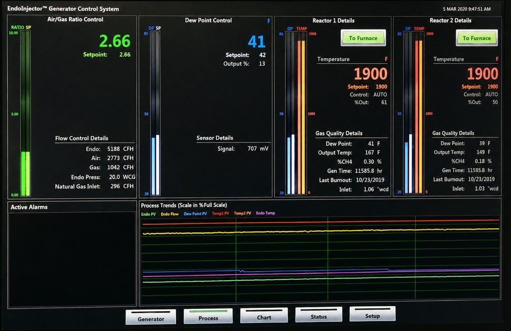

Today, and for roughly the last 20+ years, the “modern” thinking is to run endothermic gas generators at temperatures in the range of 1900°F–2000°F, depending on the manufacturer’s design and the materials and size (diameter and length) of the retort. Air/gas ratios (for natural gas) should be between 2.5:1 to 3.5:1 (Figure 2). Ratios as low as 2.0:1 can be run at higher generator operating temperatures. Gas and/or air additions are then done at the furnace for better process control.
Experience has shown that a generator running at 1900°F with an air gas ratio between 3.0:1 and 3.5:1 and an output dewpoint of +42°F provides the best combination of a stable process gas and maximum generator life.
A generator dew point range held between +40°F and +45°F reduces maintenance on the generator and decreases the frequency of performing air burnouts of the catalyst bed, which at these dew points only needs to be done approximately once a month. It also extends the life of the catalyst (upwards of 2+ years) and makes it easier for the modern controls to regulate the system. Remember, however, that gas transmission from the generator to the furnace can often raise the incoming furnace dew point by +5°F to +10°F.
