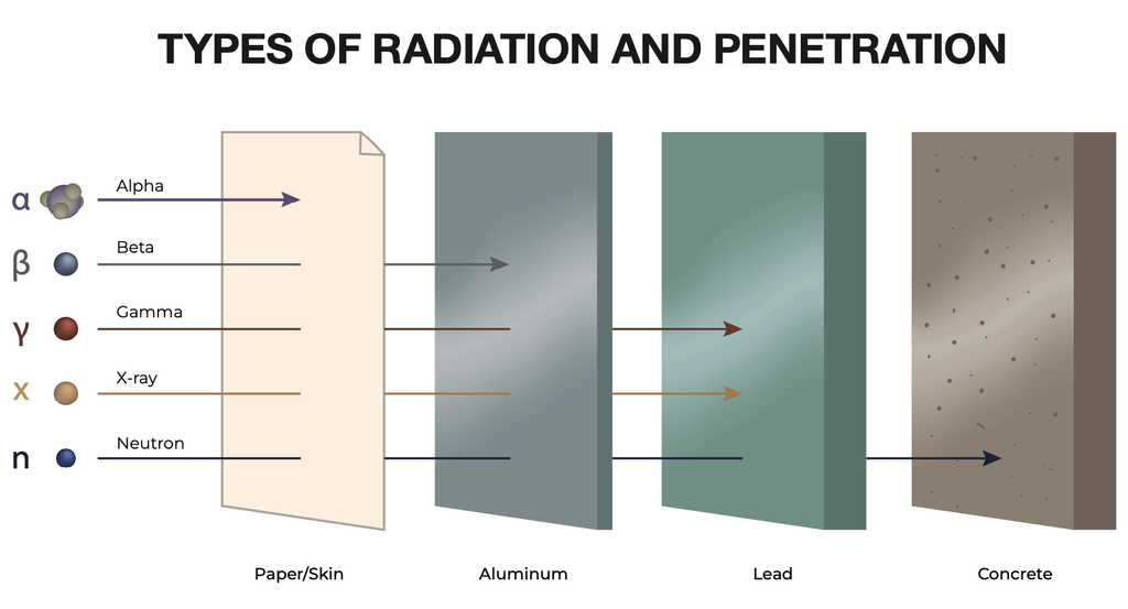

This leads us to radiation. Ansys Engineering describes radiation as the mechanism that transfers heat energy as electromagnetic waves or photons. That’s right, Capt. Kirk, that phaser technology might just be real! In other words, thermal energy can cause the atoms in any matter to move. The movement of those charged particles (protons and electrons at an atomic level) will result in the release of electromagnetic radiation. In its purest form, radiation heat transfer will only occur in a vacuum or through a medium that is transparent to the radiation. Furnace atmospheres come to mind.
Also, re-radiation is possible from an object, such as a heat treating load, so the radiant source is also absorbing radiation some of the time. Radiation transfer is very efficient and is used effectively in radiant tube furnaces. The tubes are heated electrically or by gas burners, and when they begin to glow (somewhere around 1250°F), they begin in earnest to try and bring the furnace or the load up to temperature.
Image Credit: Ashikul / AdobeStock
