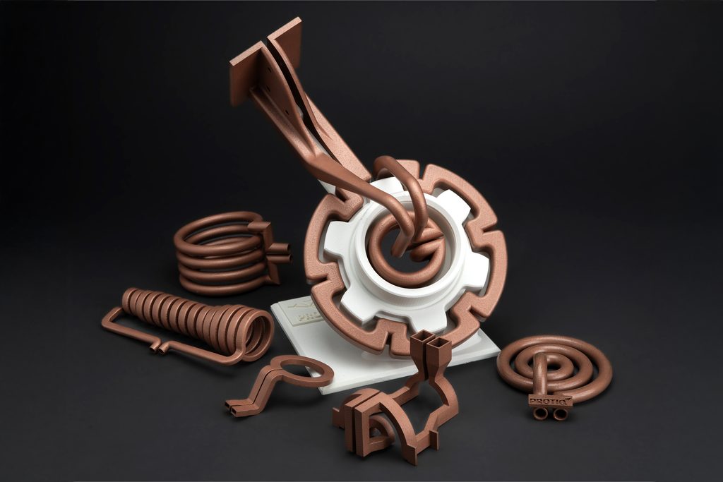

3D Printing as a Design Enabler
Additive manufacturing, often referred to as industrial 3D printing, is a production technology that creates metal components directly from digital design data. In processes like laser powder bed fusion (LPBF, often called SLM), a high-power laser selectively melts thin layers of metal powder. By repeating this process layer by layer, complex metal parts can be produced without the need for molds, tooling, or many of the manufacturing steps associated with conventional production methods.
This manufacturing approach offers a fundamentally different level of design freedom. Traditional manufacturing processes often require designers to adapt component geometries to machining, forming, or joining constraints. With additive manufacturing, many of these restrictions can be reduced or eliminated, allowing engineers to focus more directly on the functional requirements of the heat treatment application.
For induction heating, this means that the geometry of the inductor can be tailored more closely to the desired electromagnetic field distribution and heating characteristics. As a result, component design, process requirements, and performance objectives can be aligned more effectively.
Another important advantage is the ability to manufacture inductors as monolithic components. Instead of assembling multiple individual parts, the inductor can be produced in a single piece. This eliminates joints that may act as potential mechanical weak points while also enabling the integration of internal features, such as cooling channels. These channels can follow complex three-dimensional paths that would be difficult or impossible to realize with conventional manufacturing methods, enabling more targeted and efficient thermal management.

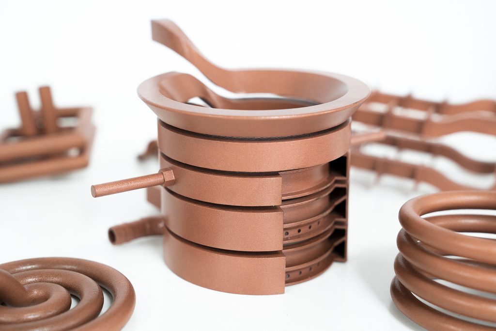

Impact on Induction Heating Performance
The increased design freedom enabled by additive manufacturing translates directly into improved process performance. When the geometry of the inductor is closely matched to the component, the electromagnetic field can be shaped more precisely. This allows for a more uniform temperature distribution, which is essential for achieving consistent material properties in heat treated parts.
Optimized geometries also improve the coupling of energy into the workpiece. In practical terms, this means that the required heating energy can be delivered more efficiently, often resulting in shorter cycle times. At the same time, improved cooling concepts help stabilize the process by keeping the inductor within its operating limits, even under demanding conditions.
Because additive manufacturing allows components to be reproduced with high accuracy, it also supports consistent process results. Compared to manually fabricated coils, this reproducibility reduces variability and contributes to overall process stability. The absence of soldered or welded joints can further increase service life, as common failure mechanisms are eliminated by design.

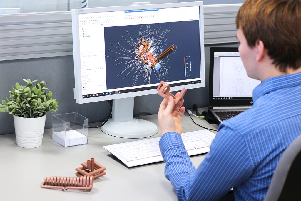

Bridging Design and Reality Through Simulation and Experience
Simulation tools are an important element in the development of modern inductors. They provide insights into electromagnetic field distribution and thermal behavior, allowing engineers to evaluate and optimize designs before manufacturing.
However, simulation alone cannot fully predict how a component will perform under real operating conditions. Factors, such as material characteristics, surface quality, and manufacturing tolerances, can influence actual results. For this reason, experience in both additive manufacturing and induction applications remains essential.
In practice, effective inductor development is based on a combination of simulation, engineering expertise, and manufacturing know-how. This integrated approach helps ensure that theoretical designs can be translated into reliable solutions for industrial use.
