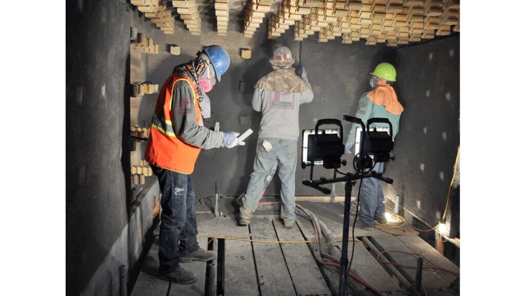

Refractory engineers working on refractory layer

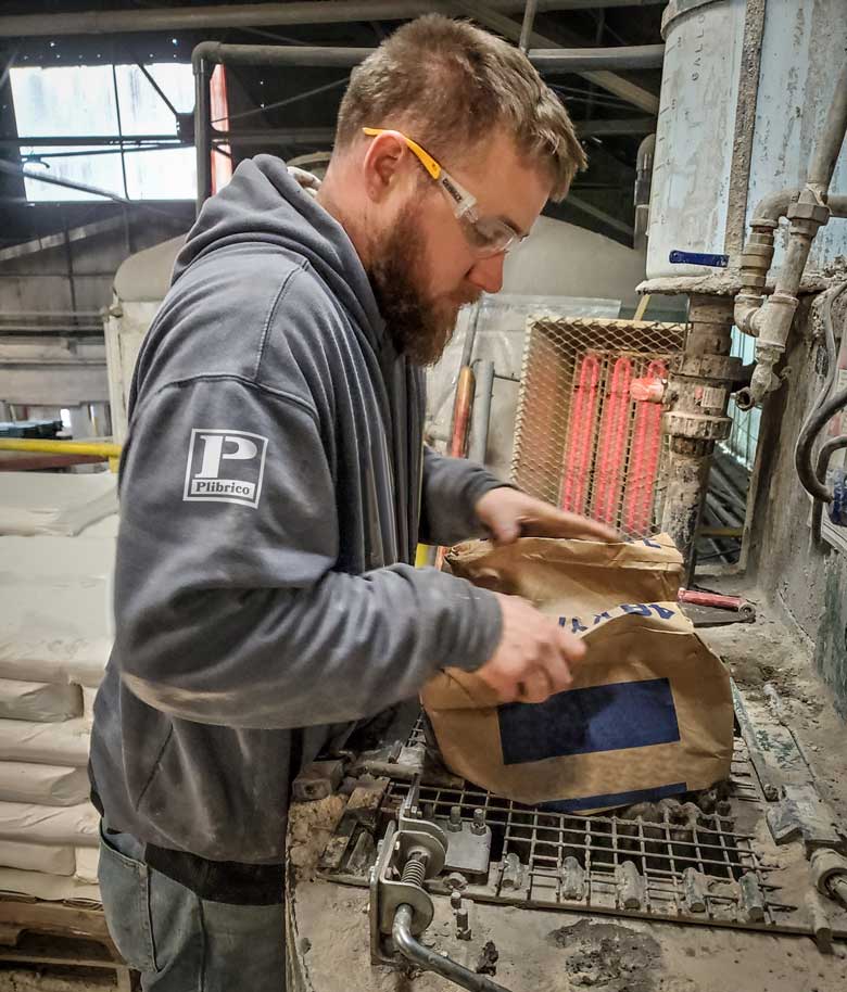

Preparing for mixing
