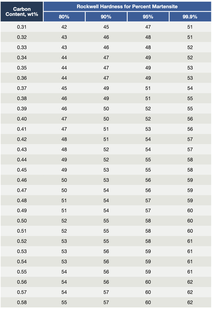

Table A. Carbon Content vs. Hardness for Different Martensite Levels (Dossett 2007)
Problems in specifying the proper steel grade for a particular application generally involve choosing a steel grade that cannot be hardened to the specification and/or specifying a surface or core hardness range that is too restrictive. For example, Table A provides a guideline for the maximum surface hardness achievable using induction or flame hardening treatments. The maximum obtainable hardness is a function of the carbon content of the steel being used.
If the material selected is 4140H with a carbon range of 0.37–0.44%, we would expect the surface to be approximately 99.9% martensite after quenching. Thus, the expected as-quenched hardness would fall in the range of 54–58 HRC for all the heats of this steel. However, the ability to achieve this hardness depends on the severity of quenching, the quenchant used, the quench tank design, and the adequate removal of surface decarburization that might be present on the wrought steel itself.

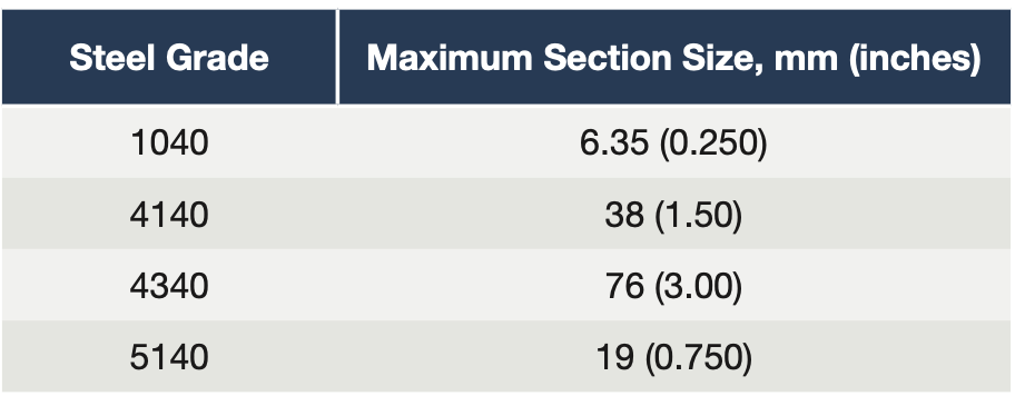

Table B. Maximum Surface Hardness as a Function of Section Size (Chandlar 1995)

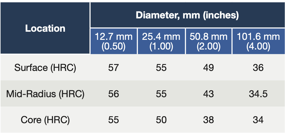

Table C. Mass Effect on Maximum Surface Hardness: (Oil) Quenched 4140 Steel (0.40%C) (Bethlehem Steel Company 1949)

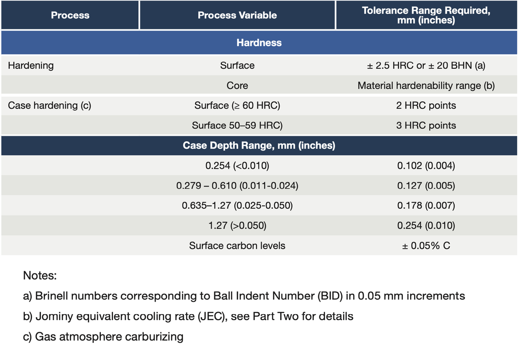

By contrast, in the case of furnace heat treatment, the maximum attainable surface hardness depends both on steel’s carbon content and its hardenability. The maximum section size (Table B) and effect of mass (Table C) are shown for several steel grades based on oil quenching. The commercially accepted range for surface hardness after tempering is ± 2.5 HRC points or ± 20 BHN points (Table D).
Table D. Commercially Desired Print Specification Tolerances for Properly Specified Materials
