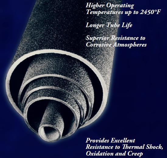

Heat Treat Tip #16
Where NOT to Use Silicon Carbide Radiant Tube
Although silicon carbide radiant tubes crank out twice the heat flux of radiant tubes and last decades longer than many alloy tubes, there are SOME places where these tubes should not be used. If any of the following apply to your heat treat situation, you should avoid these tubes; if not, you might want to put them to the test. Don’t use a silicon carbide radiant tube if . . .
1. Whenever there is a high probability that the tubes will be bumped either by the load or loading mechanism.
2. Whenever there is a high probability that parts will fall on the tube you will either have to shield the tube or avoid them altogether.
Submitted by INEX Inc.
