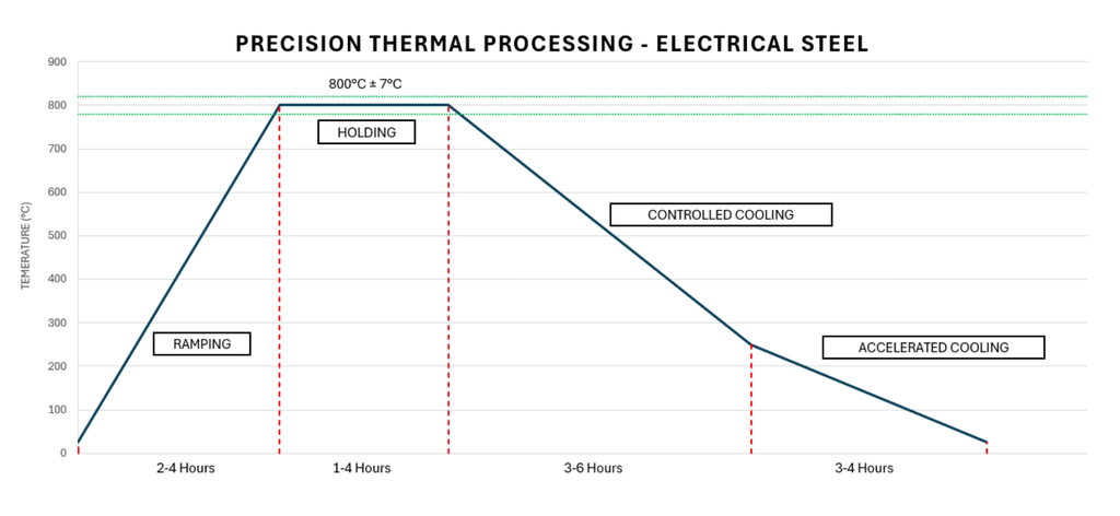

The Importance of Product Temperature
One of the most important considerations in electrical steel heat treatment is the difference between furnace temperature and actual product temperature. A furnace controller may indicate that the chamber has reached setpoint while the center of a large core remains substantially cooler. The material responds to its actual thermal history, not the temperature displayed by the furnace controller.
Product temperature measurement and temperature mapping are therefore important tools for process development and validation. They can establish:
- Heating rate and thermal lag
- Minimum and maximum product temperatures
- Temperature uniformity throughout the load (± 7°C in some cases)
- Effective soak time
- Cooling response

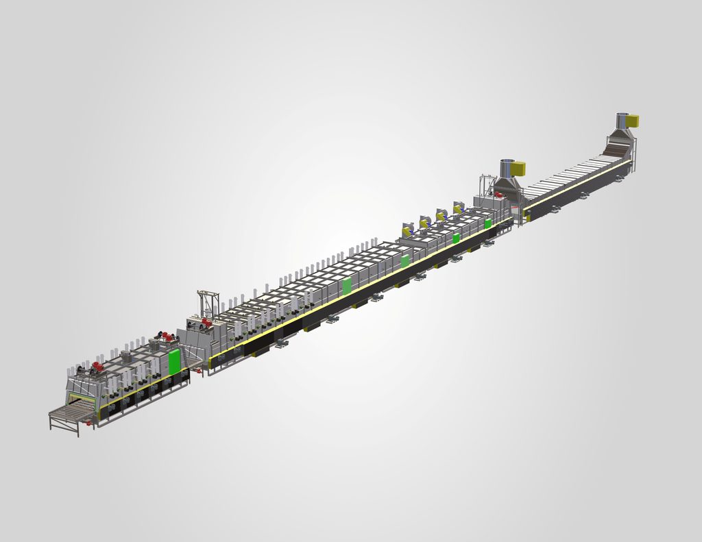

Electrical steel applications vary considerably, and the thermal processing system must reflect those differences. Motor laminations and large transformer cores can have very different thermal characteristics. Product geometry, lamination thickness, thermal mass, and loading arrangement all influence furnace design. Other considerations include stamping oil burn-off requirements, product spacing, heating method, atmosphere, throughput, and cycle time.
Batch furnaces can provide the flexibility required for large transformer cores, varying product sizes, and lower-volume production. Continuous systems can offer advantages for high-volume motor lamination production where throughput, repeatability, automated handling, and operating efficiency are priorities.
The appropriate furnace capacities can range from 5,000 lbs/hr to over 20,000 lbs/hr. The configuration, overall length, and floorspace requirements are ultimately determined by the product and thermal process requirements.
