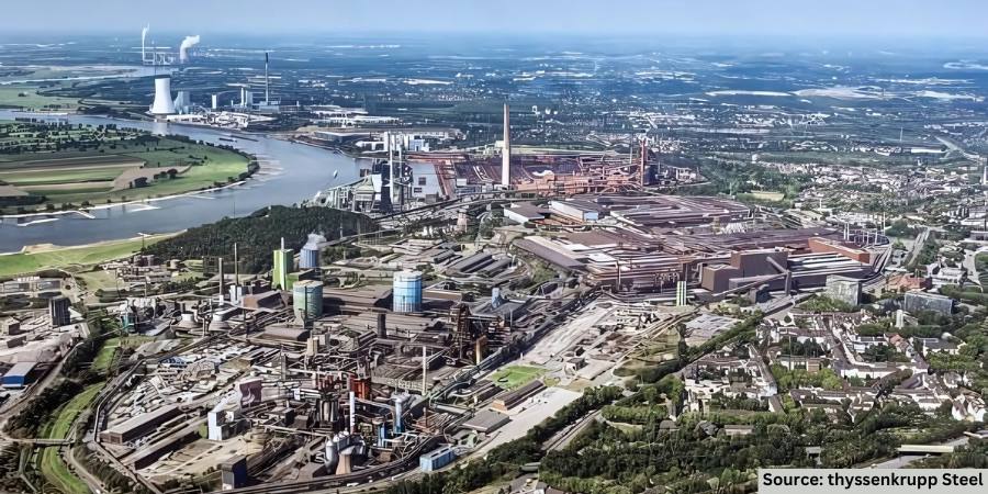

Main image caption: thyssenkrupp Steel Bruckhausen plant, Duisburg, Germany
