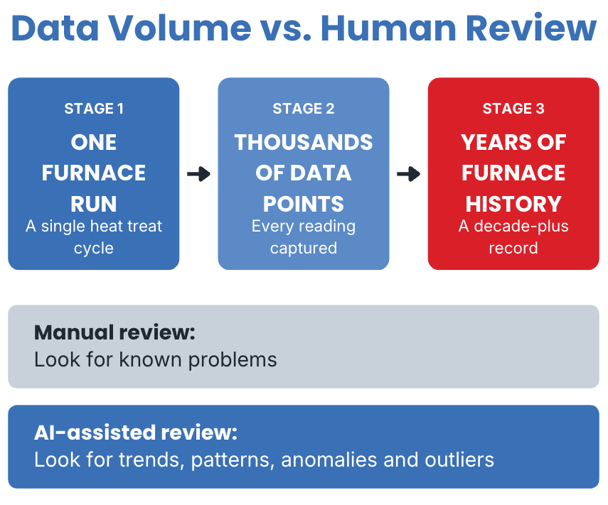

Steven Christopher: A couple of years ago, everyone started saying, ” I got this NCR because I missed this pyrometry finding. I didn’t record this correction factor. I didn’t do the math correctly. I made some mistake.” So what happened? A few people came in and created pyrometry software to avoid all these problems, to help dot the I’s and cross the T’s. It’s wonderful. The problem with data review, and the challenging part of data review for us, is that it’s not as perfect a fit and not as defined as SATs and TUSs. So, it was always a challenge and difficult for us to do. But I think that becomes a perfect fit for where AI and computing power are going.
Going back to your original question, I think data review is where pyrometry was two and three years ago, but it’s there now. The human brain, the human experience, is all focused on the big stuff. In terms of heat treat, I’m worried about time and temperature. Did I get there? Did I overshoot? But the devil is in the details. For us that means: was my dew point negative enough? Was my quench temperature where I needed it to be? Did it rise too much? All of these little things are the challenge for us, and that’s what’s exciting.
Where we are now is that we’re able to review charts in a reasonable amount of time and tell people, “This was good, this was bad, or maybe you just need to look here and explore a little bit more.”

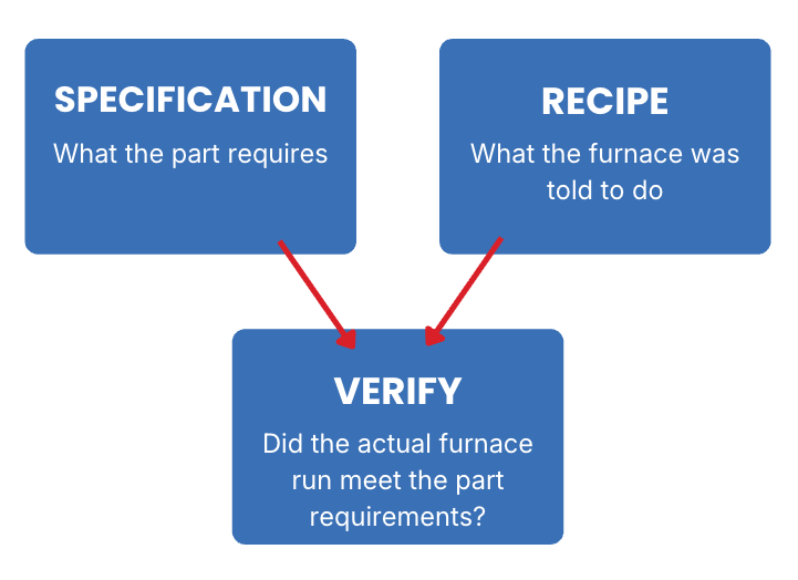

Steven Christopher: Going back to your original question about how we tie the specs in and make sure you’re doing what you’re supposed to be doing, I’d say it’s twofold. The one current thing for us, which we’ve been talking about at FNA again last week, is GoalPost, the big software we’re discussing. That is essentially our auditing process for “did I run what I said I was going to run?” It is the answer. It’s the time saver. Labor is a real problem now.
Heather Falcone: When I saw it, I almost fell over. I was standing there, and every inspector I’ve ever worked with is just going to die.
Steven Christopher: I showed 50 people last week at FNA, and they all said, “Well, that is just going to save me however many hours a week.”
Heather Falcone: It’s incredible.
Steven Christopher: The idea is that you build a specification, you build a program, and then did it do what you told it to do? How many things can go wrong?
Heather Falcone: Multitudes.
Steven Christopher: Overshoot, undershoot. We’re talking about quench and dew points and flows and dissociations. It’s a million different things. Rather than having to go through a chart, because even a good person on their best day, and for the most part we don’t always have the best people, it’s a challenge.
Heather Falcone: We’re working with what we have. The industry is changing so much.
Steven Christopher: And that’s not a knock. But even the best person on the best day, this is a challenge. And for that best person, do they have all the time in the day to review these charts? Nobody has all the time in the day.
Heather Falcone: And the volume that a normal heat treater, commercial or captive, is dealing with.
Steven Christopher: A hundred percent. So now we have this challenge of review, and GoalPost allows people to literally, at the click of a button, tell me: did I do what I was supposed to do?
Heather Falcone: It’s so cool. It’s like red and green. Green, good. Red, bad.
Steven Christopher: Go, no-go. It just passes. So we’re really excited about that.
But back to the crux of the original question, which was how do we make sure we’re checking the right information in the first place? One of the big realizations we had early on was that you can build all these sanity checks into your recipe. What if somebody runs the wrong recipe? If you’re checking yourself against yourself, no, you always have a peer — you have to have a peer review process. So for us, that was an important realization: I can’t just create a recipe and then ask, “Did that recipe do what it needed to do?” I need to create both a recipe and a specification, because the specification is what’s tied to the part, and the recipe is tied to the part as well. Now those can work together to say, “Did I do what I needed to for this part, to get the right metallurgy, to get it out the door?”

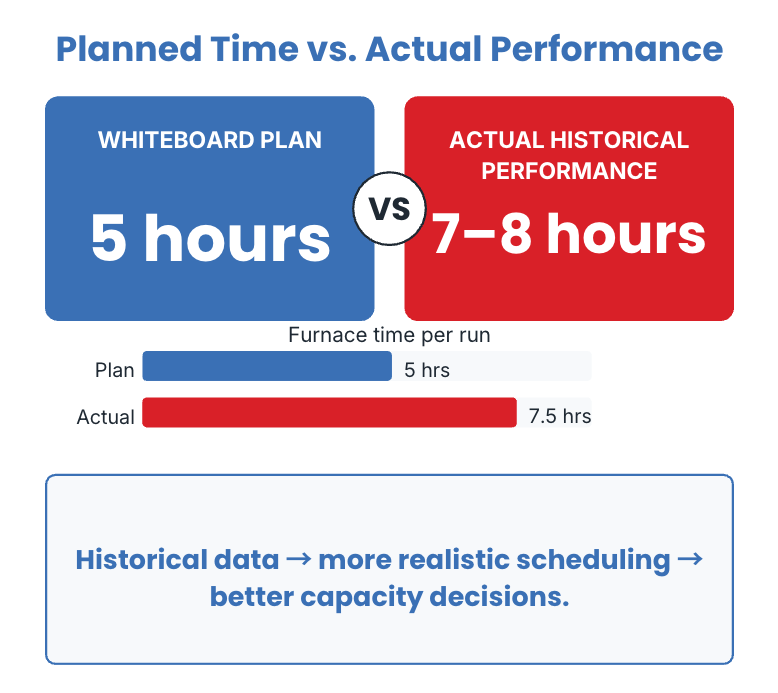

Steven Christopher: Speaking of furnaces down, I think utilization is a good point. Uptime, downtime. That’s where AI is really going for us. Within that, again, it comes back to this LoadEntry module we talked about, but scheduling is a big one for us. It’s in a gray area, because ERP systems schedule, but people still have their whiteboards that they schedule on.
Heather Falcone: I was going to say, what are you talking about? We have an Excel spreadsheet.
Steven Christopher: Right, but wouldn’t it be cool if the system just did that for you? What’s neat in getting into utilization and AI is one very simple thing we do. When you go to schedule a load, if you have a job that’s five hours of heat on your whiteboard, how much time does that take? About five hours?
Heather Falcone: However long you put the little brackets on in the black marker.
Steven Christopher: But our system is looking at the last 10 or 20 times you ran that. As that process changes because the elements are going bad, it’s taking longer to heat up and cool down. It’s not a five-hour run, it’s a seven-hour or eight-hour run, and we’re placing and allocating that much time in the system. But what I think is really neat about AI’s potential is how we can improve our scheduling, understand our true capacities, and maybe even forecast jobs.
