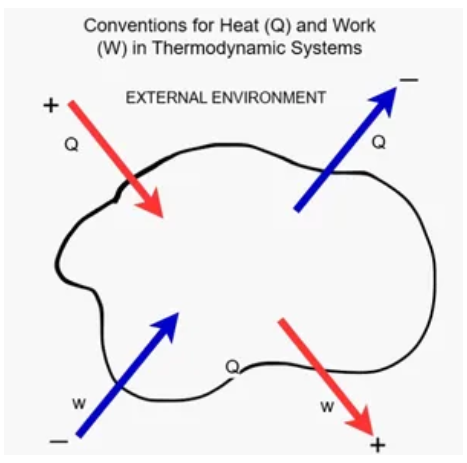

As shown in Figure 1, heat enters the furnace (designation “Q”). Heat then enters the work, which is designation “W” (e.g., load, furnace). Work absorbs most of the heat, but it also releases energy since it is starting to go towards a state of equilibrium, meaning heat in and heat released are equal. Then, the work releases energy into the area where it is not as hot and tries to heat it up and gain equilibrium. That’s the furnace guy standing there, the room, the building, etc. All of these things become the next stage of “work.”
