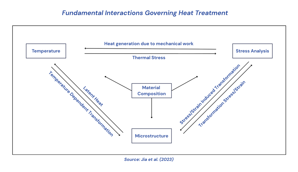

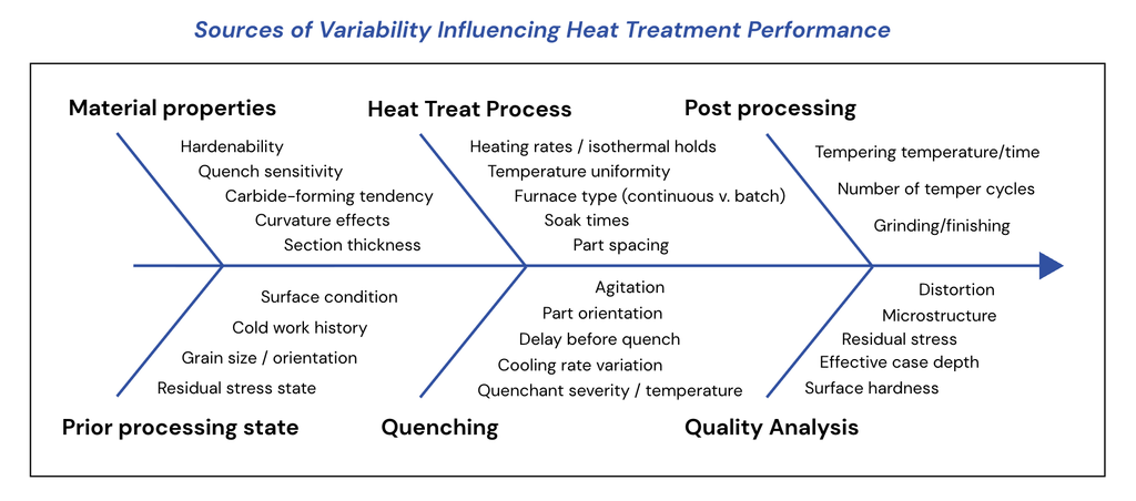

Heat treatment is one of the most operationally demanding and variable processes in modern manufacturing. It operates at the critical intersection of process design, material variability, and the strict performance requirements of industries as diverse as automotive, aerospace, and construction.
As a result, even highly experienced heat treaters must routinely make high-stakes decisions: how to converge on a new recipe without expensive trial-and-error; how to increase throughput without sacrificing quality; and whether a deviation warrants rework or scrap.
Heat treaters are uniquely positioned to benefit from advances in machine learning when confronting these decisions. Years of archived process data, hardness measurements, and quality records represent a largely untapped resource.

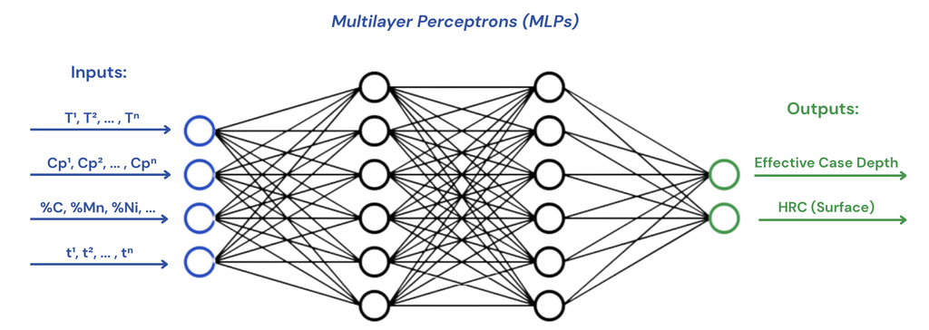

Machine learning (ML) refers to computer algorithms designed to learn how a system behaves by leveraging that system’s data. Among the most relevant ML models for heat treatment are multilayer perceptrons (MLPs), which are designed to learn complex, nonlinear relationships between process inputs and observed outcomes.
In heat treatment, outcomes such as surface hardness, effective case depth, distortion, or residual stress do not depend on any single variable. They emerge from the simultaneous interactions between variables like temperature, time, atmosphere composition, material composition, part geometry, and quench severity and uniformity, to name a few.
MLPs are well suited to modeling precisely this type of behavior. Rather than assuming a predefined relationship or physical law, they learn the mapping from process parameters to measured outcomes directly from historical production data. Layer by layer, the model captures increasingly subtle interactions among variables, enabling it to represent effects that are difficult to express with predetermined equations.
Importantly, once trained on sufficiently representative data, MLPs can:
- Predict part properties for proposed recipes in milliseconds.
- Evaluate hundreds of candidate parameter combinations rapidly.
- Provide explicit uncertainty estimates alongside predictions.
- Be tuned to individual furnaces, load configurations, or heat treatment techniques.

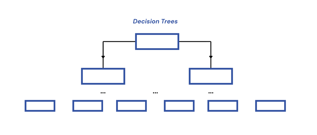

While MLPs are well suited to modeling the complexity of the heat treatment process, another class of machine learning models called decision trees are particularly effective for structured operational decisions. Heat treatment routinely requires categorical judgments, from rework decisions to detecting process drift to root cause analysis.
Decision trees can categorize heat treatment runs based on how they differ from historical runs. For example, the tree may organize a run based on its temperature deviations, fluctuations in carbon potential, or variation in effective case depth from the average. Each terminal node or “leaf” of the tree represents a cluster of historically similar runs.
Because these clusters are associated with prior corrective actions and results, the tree can provide probabilistic guidance grounded in historical precedent. For example, when analyzing a recent batch of parts that missed their target case depth, the tree might find that among comparable historical runs, 80% were successfully re-processed under a modified cycle, while 20% were scrapped. This enables faster root cause analysis and supports decision making.

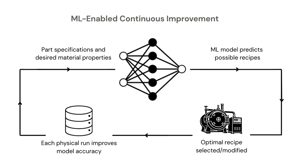

ML models such as MLPs offer a complementary approach to physical simulations. Trained on historical production data, they learn how a specific furnace, material, and process behave under real production conditions. Once trained, these models can rapidly evaluate candidate recipes against hardness, case depth, and distortion targets.
Importantly, predictions can be accompanied by uncertainty estimates, allowing heat treaters to assess risk alongside expected performance. By reducing the number of physical trial runs required to converge on a robust recipe, ML can accelerate the path from testing to production while preserving metallurgical oversight.

Rather than relying solely on sequential physical trials, heat treaters can assess proposed modifications computationally before allocating furnace capacity.
Each additional production run further refines the model. As data accumulate across varying materials, geometries, and operating conditions, predictive fidelity improves. Over time, optimization transitions from periodic study to continuous, data-driven improvement.

Decision-tree-based models provide a structured method for accelerating this analysis. By learning from historical runs and their documented outcomes, the model can classify a new deviation according to its similarity to past cases. For example, the model may determine that comparable historical runs were most frequently associated with temperature non-uniformity rather than alternative causes.
This approach offers three practical advantages:
- Faster root cause analysis and reduced diagnostic downtime.
- More consistent, data-backed rework decisions.
- Earlier detection of process drift and emerging equipment issues.
Importantly, these models do not override heat treaters’ judgment. Rather, they surface structured historical context that may otherwise remain fragmented across logs and institutional memory. Over time, this improves consistency, auditability, and knowledge transfer.
