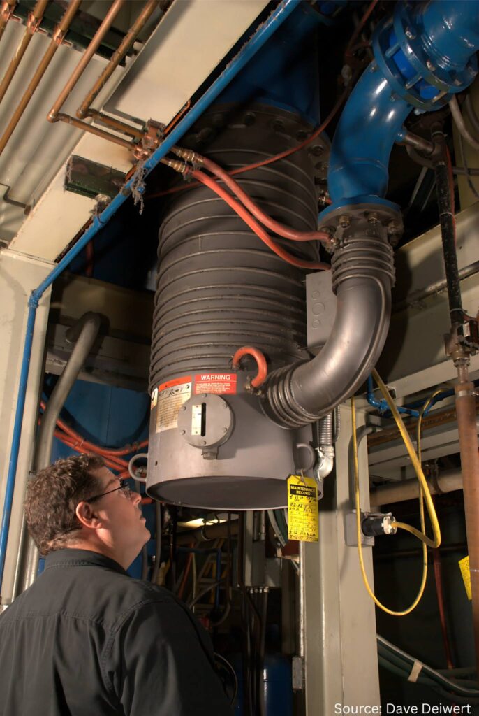

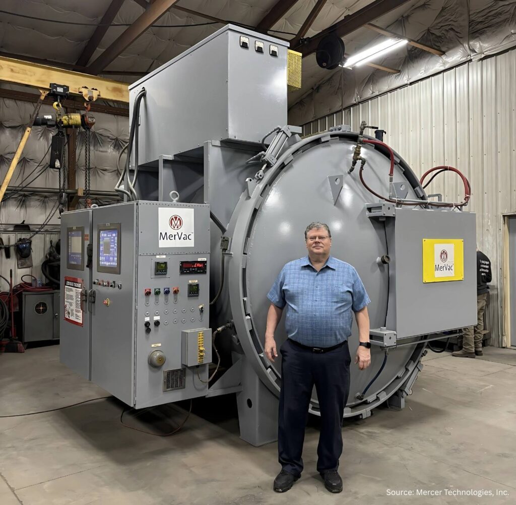

Where To Connect the Leak Detector
Th ere has been much discussion over the years on where to connect the leak detector to a vacuum furnace. Some think that because they are leak testing a furnace they should connect the leak detector directly to the furnace. While you can do that, you are asking a leak detector — typically with an NW25 vacuum connection or some type of hose barb connector — to compete with the typically very large port of the diffusion pump; in systems without a diffusion pump, the leak detector competes with the blower. In molecular flow level of vacuum, the conductance of helium to that 1” target is significantly lower than the conductance to the port of the valve to the diffusion pump or the blower (imagine a 1” vs. a 10” connection, for example).

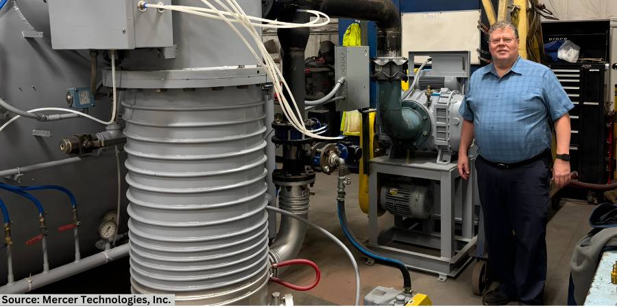

It is best to connect to a port near the inlet of the blower, which is typically available. You would still be using an NW25 vacuum connection or smaller hose barb fitting, but you will be sampling the flow to the blower. The recommended connections from the leak detection to the blower should all be the same as to the leak detector test port. Using smaller connectors to the leak detector diminishes conductance to the leak detector from the furnace. This, in turn, decreases the performance of the leak detector.
It is also best to have a manually operated NW25 ball valve that is permanently installed at this point, which would be closed normally with a “blank” fitting clamped to the port on that valve. This would facilitate the following recommendation that preventative maintenance leak checks be completed during long furnace processes.
