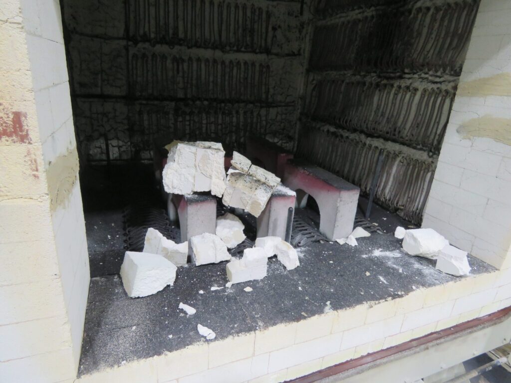

Figure 1. Debris from a damaged atmosphere furnace that collapsed on a hearth
Source: Ipsen

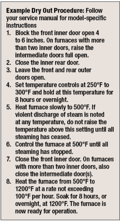

  • Perform a “dry out” procedure and clean the quench tank before refilling the tank. See “Example Dry Out Procedure” break-out box.
