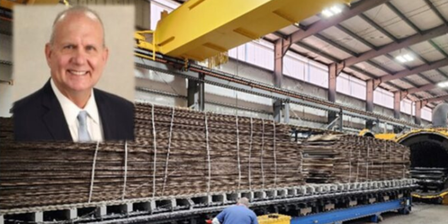

A western PA heat treater recently degassed 175,000 pounds of 6AI-4V titanium in their 48-foot-long vacuum furnace. This is the largest and heaviest single load of titanium ever processed in the company's history.
Solar Atmospheres of Western PA vacuum degassed the load consisting of 154 sheets of titanium 40” x 240”. Their president, Bob Hill, states, “The future of the global aerospace titanium market is very promising with the many opportunities in the commercial and military aircraft markets!”
