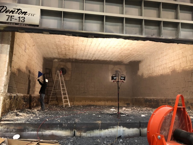

DG: All right, so let’s talk a little bit about application of the product. Just in a nutshell, what does it take to apply it? Is this a thermal spray? How do you apply it?
GO: It’s applied by spraying it on. It’s not thermal, thermally sprayed or applied. You know, the best way to apply it is — I tell a lot of our customers that want to do this themselves – the best way to apply it is to go to Home Depot or Lowes and buy yourself a textured drywall popper spray gun. You can get them for $70 or $80 and use that to apply it. It’s okay for heat treat furnaces that aren’t very large in size. We’ve done those that may be 32 feet long by 16 feet wide and 15 feet high — somewhere in that range. It’s okay in that size. When you move into a reheat furnace in a steel mill, there are sprayers that can be rented or purchased. They are also drywall spray guns, but they are self – contained with a 15-gallon hopper on the unit, so that the actual applicator is only holding onto a gun and not a hopper full of material. Which can get pretty heavy over time.
DG: Right. So it’s basically as simple as painting your house with a spray gun.
GO: Yeah, pretty much. You know some people will ask me, well I’ve got a paint sprayer here, can I use that? And the answer to that is “No.” Paint sprayers have filters and screens in them, and the problem is you’re going to filter out and screen out all of the ceramics that are in it, so, really all you’d be applying is the water that it’s mixed with.
DG: Okay, okay. So I assume you recommend that your team, your crew, applies it. It can be done by the homeowner, so to speak — the furnace owner — but probably better if your guys apply it?
GO: I would say initially, “Yes.” We always want to come in and do the first one, two, three applications for a customer. And during those applications, if they want to learn, they are more than welcome to sit there with us while we mix and apply so that they could get a good general knowledge and hands-on training at the time, to be able to move forward and apply it themselves. We do have some certified product installers around the country: NorHeat Treatment, Inc, out of Canada, Thermal Coating Solutions here in Pittsburgh. We do have some other people down south that do it for us. We have a gentleman over in Chicago that handles more or less our cement world and energy world, but, yeah, so, it can be applied by the customer but we definitely recommend ITC do the first one or two installs. Then you can learn the ropes.
Prep, Downtime, Restart
DG: Right. Now, how about surface preparation? So, I’m a, I’m a manufacturer, I’ve got a furnace in-house. It is up and running 24/7/365. I don’t want it to be down long. How much surface prep do I have to do if I take this thing out of service? How long is it out, and what do I need to do to get the surface ready, and how long, in fact, does installation and or any dry-out process take?
GO: Well, again, I’ve been in some furnaces that are in really, really bad shape. So, surface prep, on a ceramic fiber-lined furnace — depending on how hard you run it, the fiber starts to devitrify and it gets the black crusty layer over that fiber which is really no good anymore. It’s just a glassy phase that has no insulating value to you whatsoever. So, that needs to be removed. It’s depending on the size of the furnace, depending on the size of the crew, but most installations that I have been involved with – three to four days at the most. And that can even apply to a large pusher type reheat furnace in a steel mill. You know, day one would be surface prep, clean up the refractory if it needs it. Days two, three, and four would be applying the coatings. And then after that, we are done. We get out of the way. If you’ve got a brand new furnace, we can walk in, open the door, and we can have that sprayed in eight to ten hours. You can have that done in one day. Like I said, application really depends on the condition of the refractory.
DG: Right. And as far as dry out, I mean a lot of times with a refractory installation, there’s dry out times, that type of stuff. What are we looking at? Does this stuff have to be dried out? Do we need to go low heat for quite a while or does it dry like paint?
GO: Once it’s applied, the recommendation is to let it dry for 24 hours. And, then, when you start the furnace, I say, 100 degrees an hour, when you get to about 250 or 300, I like to hold it there, maybe for an hour, just to start to drive that mechanical water out of it. And then after that, 100 degrees an hour to operating temperature because then you are going to start forming the chemical bond and drive off the chemical water. You are going to sinter that coating. And you have to remember, these are only mils thick, so it’s not like conventional refractories where you’ve got 8, 9, 10 inches, and you’ve got to hold per hour, per inch thickness at 250, and then 600 and then 9 . . . You know there’s no holds just due to the thinness of the application.
