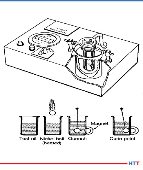

Fig.1 Schematic of ASTM D-3520 (ref. 7)

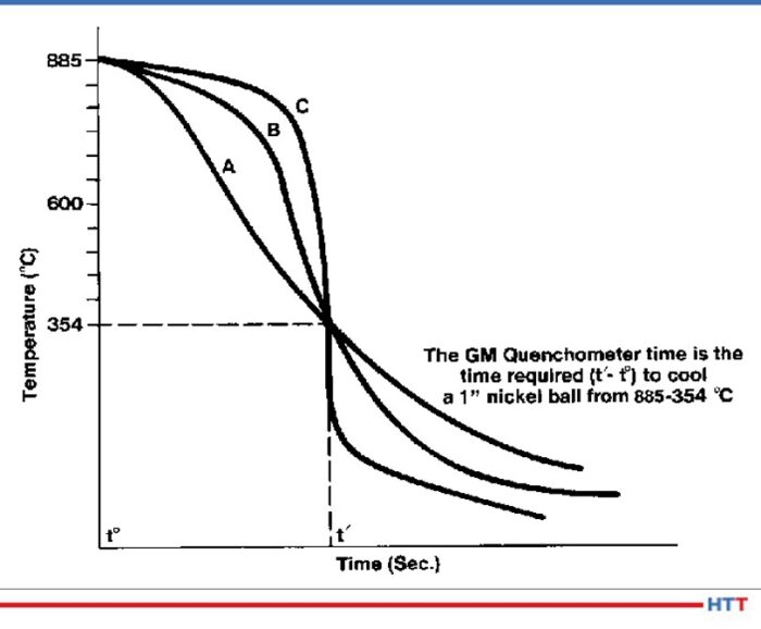

Historically, the severity of the quench has been measured by ASTM D-35202.  In this method, a chromized nickel ball is heated to 885°C and is dropped through an electronic sensor, which starts a timer, and into a steel cylinder of quench oil in a magnetic field.  Once the chromized nickel ball reaches the Currie temperature of nickel at 354°C, the ball becomes magnetic and closes the timing circuit when the ball comes into contact with the cylinder. The popularity of this test has always been that it provides a number that is easily interpreted by heat treaters to “rate” the oil as fast (9 – 11 seconds), “medium” (12 – 14 seconds), “slow” (15 – 20 seconds) or marquench (20 - 25 seconds). A schematic of the test method is shown in Figure #1.
This test worked well to differentiate between different how well the quench oils cooled the nickel ball. The test really didn’t distinguish between the cooling characteristics of a quench oil. The test result in Figure #2 show a time in seconds for the nickel ball to reach 354°C for three separate oils.  However, when the actual cooling curves of the oils are examined there are three distinct cooling curves shown.

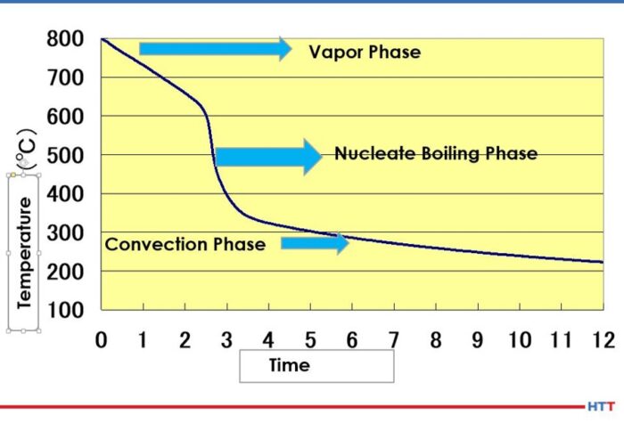

The basic cooling curve consists of three stages: the vapor blanket, nucleate boiling and convection. A basic cooling curve with the three different cooling phases is shown in Figure #3.
Fig.3 Three stage cooling curve (ref. 4)
In the vapor blanket stage, the load and the quench oil coming into contact with the load are above the evaporation temperature of the oil.  An insulating vapor blanket forms around the load and no cooling occurs.  Because the vapor blanket is insulating and does not allow for cooling, the vapor stage carries the highest risk of distortion.4  Once the vapor pressure decreases to a point where the oil can once again condense on the load and the temperature of the oil falls below the evaporation temperature, the nucleate boiling stage begins.  In this stage, the load undergoes the most aggressive cooling.  After sufficient cooling has occurred and the quench oil temperature is below the boiling temperature of the oil, a smooth transition into the convection stage begins.

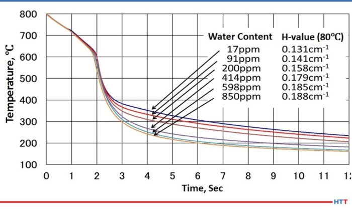

As water is dispersed throughout the oil, the viscosity of the oil changes.  As the amount of water increases, the viscosity of the oil also increases.5  A careful examination of Figure #4 will also show a slight movement of the cooling curve to the left and a lengthening of the vapor stage as the amount of water increases.  Furthermore the water in the oil is not uniformly dispersed, and this non-uniform dispersion creates uneven cooling rates throughout the oil.  To restore even cooling, it is recommended the water in the quench oil be reduced to below 200 PPM.

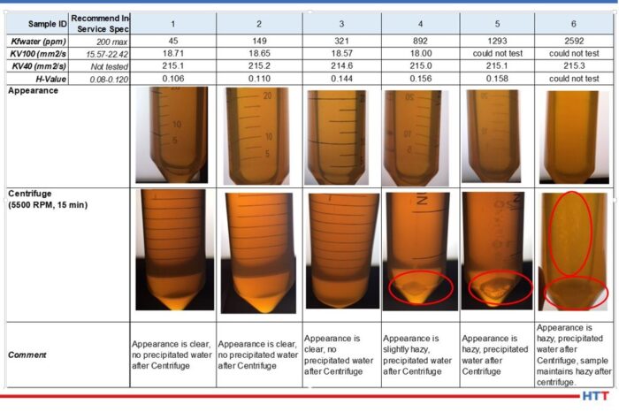

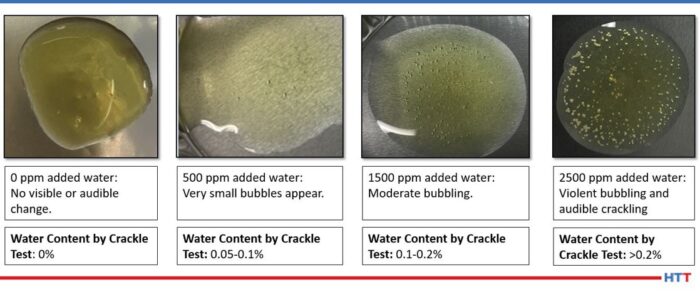

In simplistic terms, water in a quench oil can be thought of as being dispersed in the quench oil due to agitation or as free water having exceeded the saturation point of the oil.  As a general rule of thumb in the industry, the saturation point is considered to be 0.1% or 1,000 PPM.  However, the saturation point will vary according to the temperature of the oil and the additives within the quench oil.  Daphne Hi Temp A-U is a good example of a clear amber quench oil.  Figure #5 shows a picture array of the appearance of the oil as the amount of water approaches and then exceeds the 1000 PPM industry standard.
Fig. 5 Daphne Hi Temp A-U appearance as the amount of water dispersed within the oil nears and exceeds the saturation point of the oil. (Used with permission Idemitsu Lubricants America)
Notice in the data above that as the amount of water increases in the Daphne Hi Temp A-U, so does the viscosity as measured at 100°C.  In addition to the viscosity rising as the amount of dispersed water increases, so also does the quench severity as measured by the Grossman H value.  Furthermore, the appearance of the quench oil changes as the amount of water increases as well.  (See Fig. 5 for the Daphne Hi Temp A-U.) With small amounts of dispersed water—45 PPM—the quench oil is clear and there is no water that is precipitated out after centrifuging for 15 minutes at 5500 RPM.  However, as the amount of water begins to approach the 1000 PPM level, the appearance of the quench oil begins to become hazy. As the saturation point is exceeded, the appearance remains hazy and water precipitates out after centrifuging for 15 minutes at 5500 RPM.
Testing for oil in a quench oil
There are two basic types of testing methods for determining if there is water dispersed in a quench oil.  One of the methods is subjective and the other is quantitative.  The crackle test involves heating a metal coupon to approximately 400°F and placing a few drops of the quench oil on the surface.  If there is a sufficient amount of water in the oil visible bubbling within the oil and audible crackling will occur.  Unfortunately, this is typically above the saturation point of the quench oil. At which point it is often too late.  Figure #6 shows examples of crackle testing.
Fig. 6 Crackle test results for Daphne Hi Temp A-U
The second and preferred testing method is through ASTM D-6304 Standard Test Method for Determination of Water in Petroleum Products, Lubricating Oils and Additives by Coulometric Karl Fisher Titration6.  The Karl Fisher test uses the Bunsen electrochemical reaction to calculate the amount of water in a used oil and is accurate in used oil from 1 PPM to 50,000 PPM.
