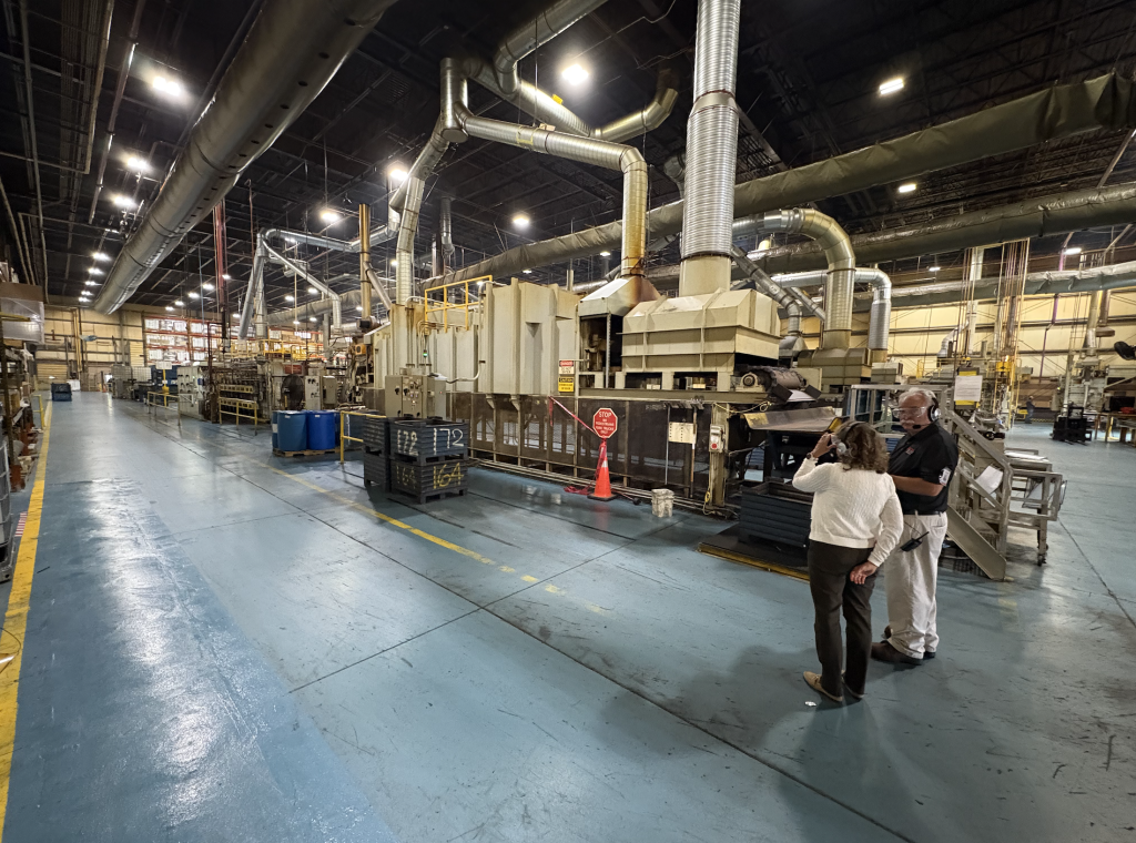

Mesh belt line | Image Credit: Heat Treat Today
When roofing fasteners are heat treated, they either go through one of the three medium- to large-scale continuous mesh belt furnace lines or through the automated integral quench (IQ) furnace line. The mesh belt line receives shorter, 1.5- to 6-inch parts that are poured from a tub onto the belt with ease as well as longer 7- to 8-inch product. On the other hand, the IQ furnace line includes two furnaces which receive longer parts up to 24 inches long from a fully automated delivery system; fasteners are hung from their heads on the rack to prevent distortion. In the future, the team looks forward to automating this part of the process.

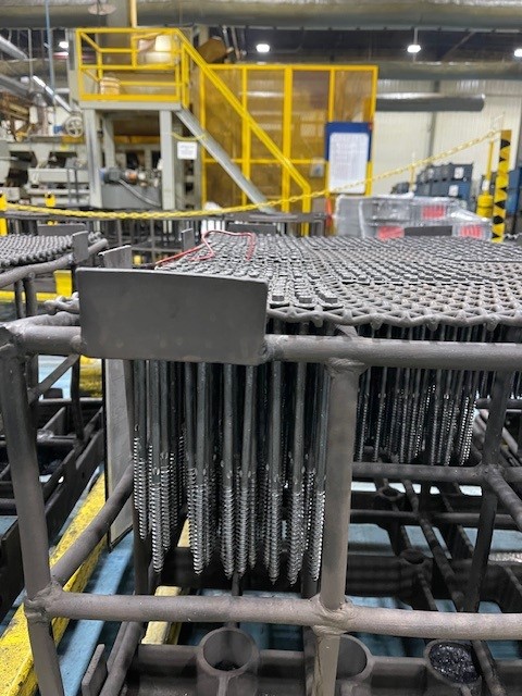

Long roofing screws are hand-racked to best control distortion. | Image Credit: Heat Treat Today

Operations feature an in-house laboratory to test product, particularly for distortion, the leading quality concern for roofing product. As mentioned earlier, furnace line automation is a goal, yet longer parts — like thin-shanked 8-inch parts — may still need to be hand-racked on the mesh belt to attain the quality results.

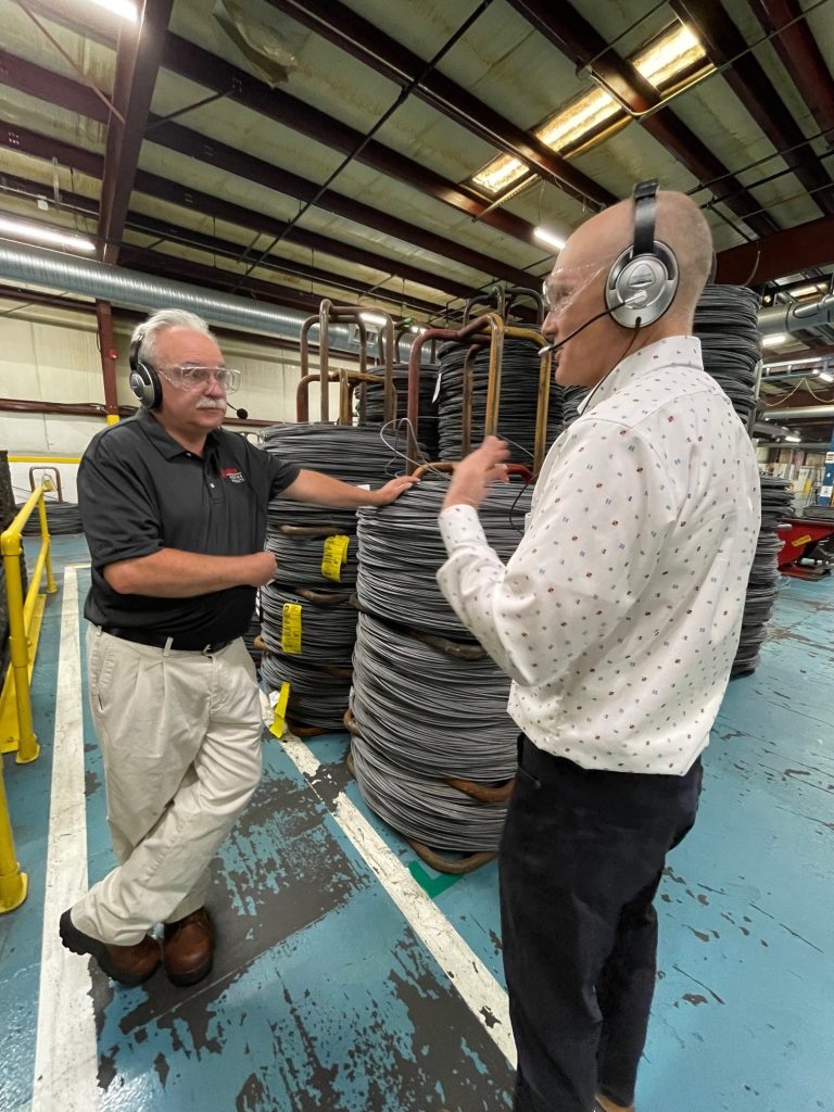

Kevin Walters, the R&D manager at OMG, explains how OMG forms spools into screw and nail roofing product to Doug Glenn, publisher of Heat Treat Today. | Image Credit: Heat Treat Today
