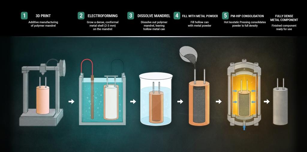

The new process begins with a 3D-printed polymer form that defines the final component geometry. Electroforming is then used to build a uniform nickel shell approximately 2–3 mm thick around the form. After the polymer is removed, the hollow metal structure is filled with metal powder, sealed, and processed using HIP to consolidate the powder into a solid component.

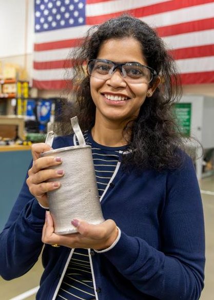

During the first phase of the project, the team produced five leak-free cylindrical HIP cans measuring 6 inches tall and 4 inches in diameter. Researchers also developed an integrated port design that eliminates the separate welding of process tubes, which can be a source of failure during the HIP process.
One of the leak-free HIP cans was used to produce a 15.7-pound solid nickel component. A second phase is now underway to apply the process to a more complex geometry — either an impeller or a valve relevant to nuclear energy systems.
