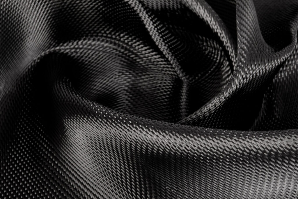

Figure 1. Carbon cloth | Image Credit: Morgan Advanced Materials

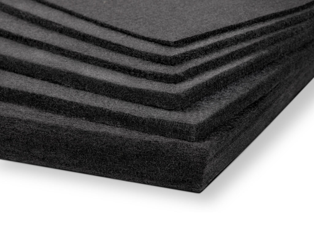

Figure 2. Felted rayon billets | Image Credit: Morgan Advanced Materials

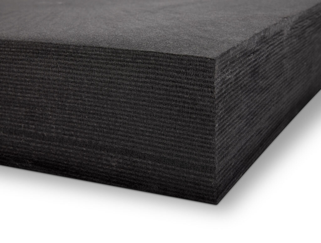

Figure 3. Rayon felt | Image Credit: Morgan Advanced Materials
