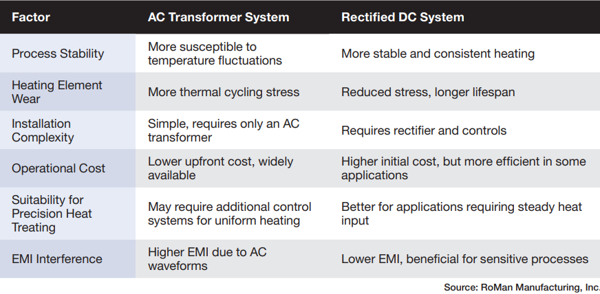

Table 1. Benefits of AC vs. rectified DC power
