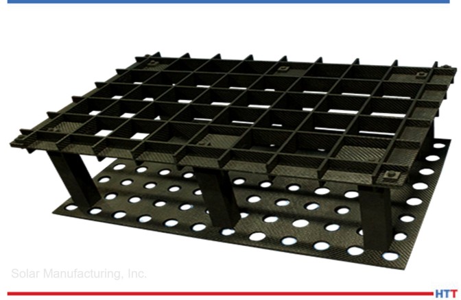

Typical Carbon/Carbon Composite Two-Tier Fixture

The carbon fiber matrix can be used to create racks, plates, grids, and fixtures for vacuum heat treating applications.
Various Configurations of C/C Used as Fixtures and Grids
