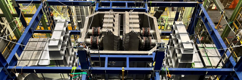

The Dangjin modernization focused on three areas: replacing the cooling section, integrating induction technology, and optimizing thermal control. The upgraded line incorporates Fives’ Dry FlashCooling technology operating with 75% hydrogen, including a recirculation system designed to reduce hydrogen and nitrogen consumption.
A 4 MW CELES induction system was installed to provide rapid and uniform heating. The modernization also incorporated Fives’ Virtuo-L digital system for thermal process control tailored to Gen3 steel production.
The new cooling system provides temperature uniformity across the width of the steel strip within ±5°C (±9°F), including at high blowing speeds. The Virtuo-L system controls process parameters in both annealing and galvanizing modes.
