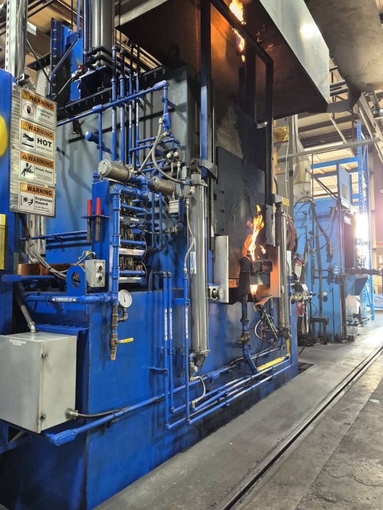

Figure 1. Atmosphere furnace during normal
operation | Image Credit: Precision Heat Treat
Ltd.

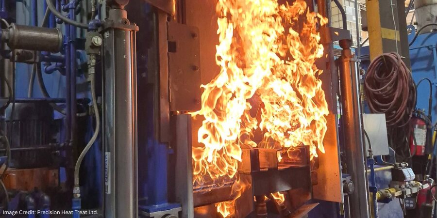

Figure 2. Vestibule door partially opened during a
controlled simulation to illustrate gas release
behavior — not an actual incident | Image Credit:
Precision Heat Treat Ltd.

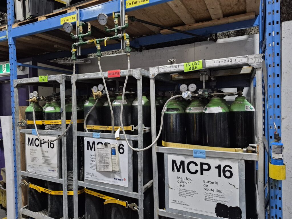

Nitrogen Purge
These steps depend on whether a nitrogen purge is available; it is highly advised that nitrogen purge be available for all IQ or straight through units. Be sure you understand how long it takes for your specific furnace to fully purge endothermic gas. While NFPA 86 recommends five volume turnovers, some experts advise planning for up to ten per hour in an emergency. Each furnace should have established purge data under normal conditions so operators can act with confidence when time is critical.
Figure 3. Bulk nitrogen supply used for emergency purging and atmosphere control | Image Credit: Precision Heat Treat Ltd.
  • Begin a nitrogen purge immediately (if available) and maintain it throughout the event.
  • Use at least the minimum flow rate specified in your documentation. If safe, higher flow may be used to help displace flammable gases from the heating and quench chambers.
  • Maintain furnace temperature at 1500°F during the purge.
