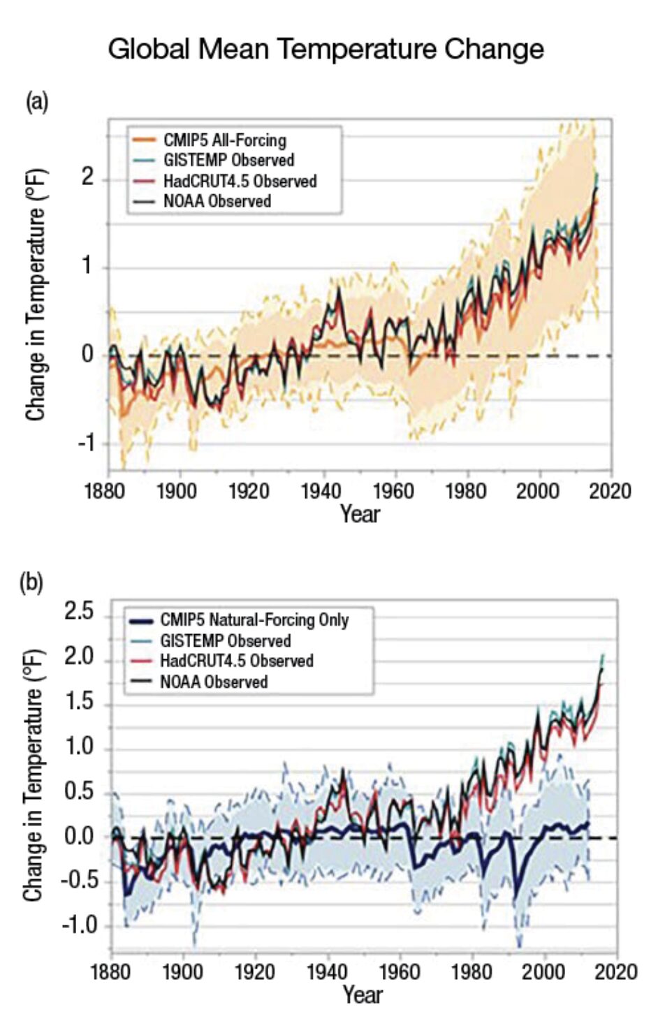

Proper science dictates that research that disagrees with the consensus should be highlighted rather than thrown aside. An investigation from 2015 found that, from a sample of 38 publicly touted papers skeptical of the scientific consensus, all 38 papers had a number of methodological flaws. When those flaws were corrected, the results of these papers aligned with the anthropogenic climate change consensus (Benestad, et al. 2015). To further illustrate the strength of this consensus, Figure 1 shows how alternative theories, like the theory that global warming is caused by natural variations in the climate, are insufficient and neither explain nor predict the future to the same accuracy as anthropogenic climate change (Wuebbles, et al. 2017). This is the scientific method in action.

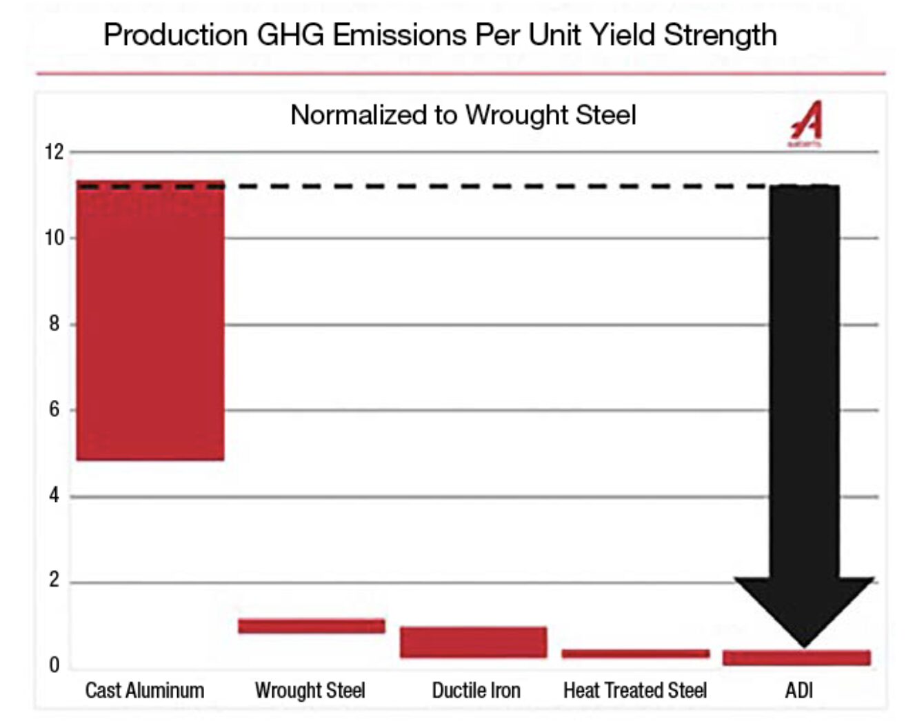

These policies result in strong financial incentives for heat treatment. The heat treatment industry is in a unique position for mitigating climate change because it can increase the strength-to-weight ratio of a material with marginal energy inputs. By reducing the total material required for a component, this optimum mitigation technique can decrease the energy and greenhouse gas emissions in all three stages of a component’s life cycle: production, use, and end-of-life.
The casting industry recognized a similar opportunity and sponsored a life cycle analysis to calculate greenhouse gas emissions and the overall energy consumption for ductile iron (Zhu, et al. 2023). The study discovered that ductile iron tends to decrease the amount of greenhouse gas emissions per unit mass of material compared to competing manufacturing methods for ferrous materials. Additionally, it was revealed that Austempered Ductile Iron (ADI), a heat-treated ductile iron, can replace alternative materials on a pound-for-pound basis and further decrease greenhouse gas emissions. (In fact, ADI components could weigh more than the alternative material and still decrease greenhouse gas emissions in a lifecycle perspective). This finding can be extended to most heat-treatable materials as production greenhouse gas emissions per unit strength tend to be less than competing materials (Figure 2).
