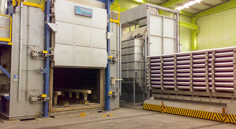

The entire homogenising centre is controlled via a modern automation platform that enables centralised monitoring of temperature profiles, cycle times, billet tracking, and system diagnostics.
“Hydro has awarded Sistem Teknik Industrial Furnaces a contract for the supply of a new aluminium logs homogenising centre at Hydro’s plant in Luce, France. The project centres on a 30-ton per charge aluminium logs homogenising centre, engineered to deliver high-capacity billet processing with optimised energy consumption and plant integration.”
“In addition to supplying new equipment, the project scope includes the modernisation and integration of selected existing systems at the Luce plant. By upgrading control logic and harmonising communication protocols, the new homogenising centre will operate as a fully integrated part of Hydro’s broader production infrastructure. This approach ensures operational continuity while introducing enhanced process control capabilities.”

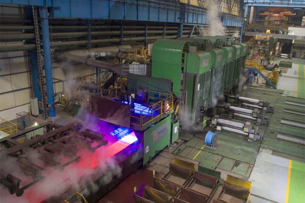

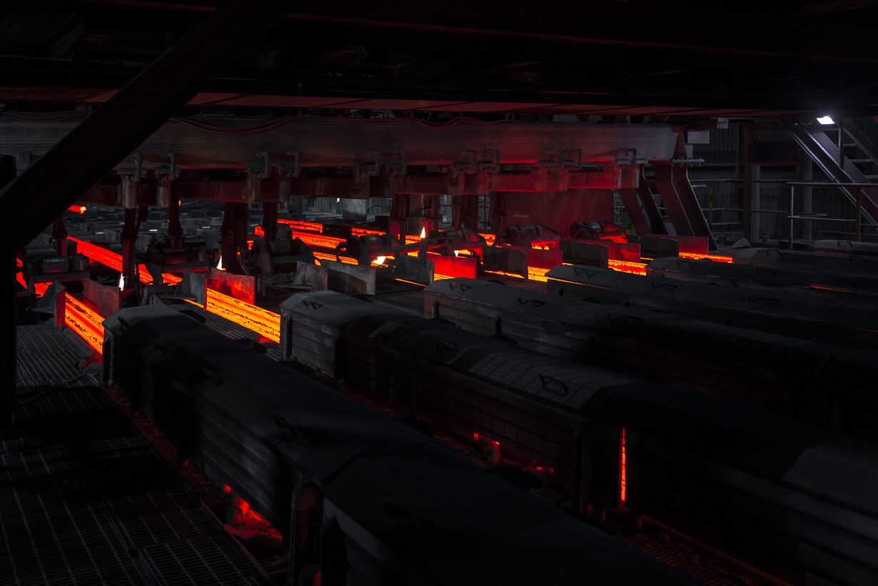

“Primetals Technologies has received the final acceptance certificate (FAC) from leading Chinese producer Rizhao Steel for the installation of the innovative LevCon Bender Anti-Bulging system on all its five Arvedi ESP high-speed casters.”
“The system combines conventional mold-level control with the ability to dynamically adjust the roller gap in the bender — hydraulically operated and position-controlled — allowing active regulation of the liquid steel volume at the top of the caster. This real-time control strategy continuously compensates for mold-level fluctuations caused by bulging, increasing average casting speeds, improving surface quality by reducing oscillation marks, and minimizing casting powder entrapment. At the same time, it significantly reduces the risk of breakouts and liquid steel overflow.”
